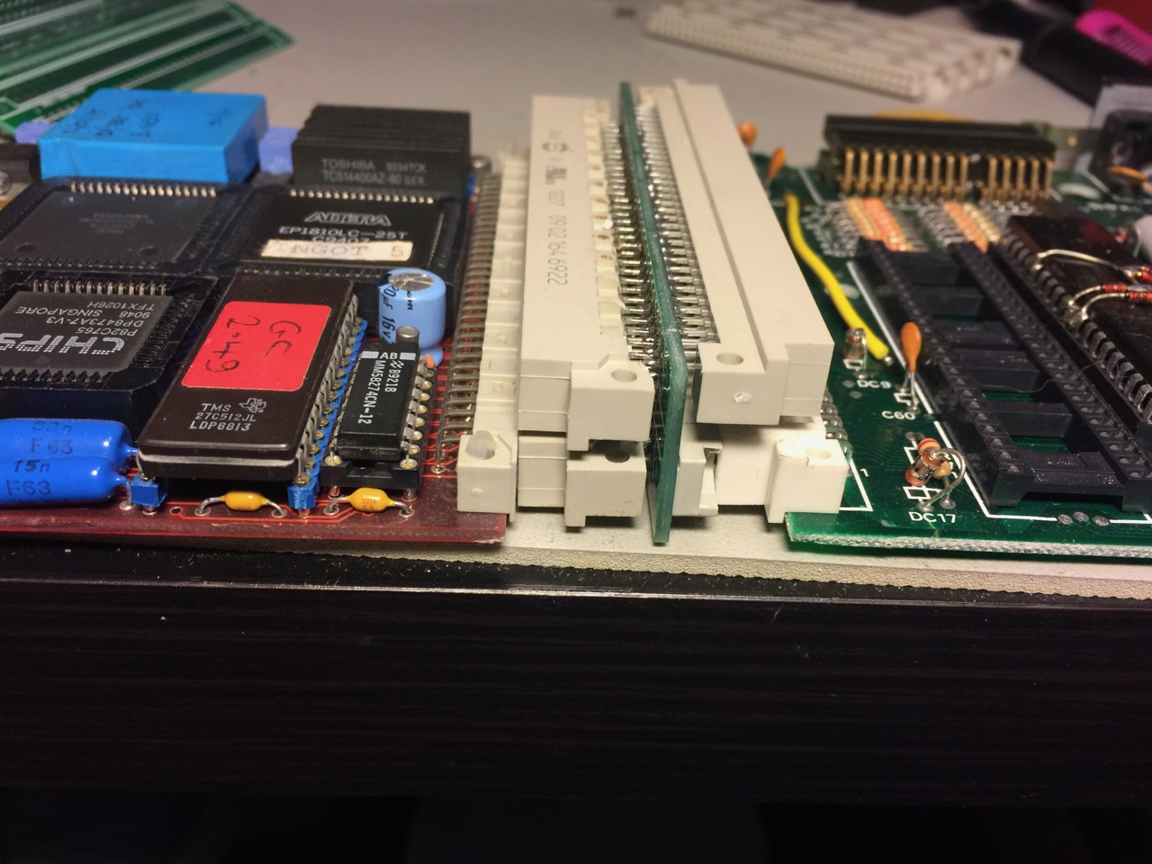

Peter: The 2200 can only handle the magnetics being up to about 40mm away and then it all goes to hell. I have the RJ45 with the magnetics built in. Are you aware of any separate magnetics that have the same characteristics? If I can identify some, I can use those and a standard RJ45, allowing it to be much further from the board. The dimensions of the ones I have are really restrictive as they're larger than ordinary RJ45s.

Suitable separate magnetics certainly exist. But I never selected any, since I prefer them integrated.
Not sure what you mean by "up to about 40mm away and then it all goes to hell".
The signals are differential, so if you have a groundplane and keep them in pairs, I don't see why the CP2200 should be so restrictive.

If the magnetics are close to the IC it works fine. I was trying to put them on a short cable so the socket could be located somewhere with more room (can't close the case) but the signal is destroyed. The datasheet also says the magnetics need to be within 3-4cm of the IC.
I've ordered a revised PCB that solves this conflict. Also fixes a missing JTAG line.

I placed the jack facing left towards the expansion port. Even very gentle wiggling of the cable makes the board jump out of the socket. The CPU sockets are UTTER CRAP. I will try with it facing backwards (exiting the ROM port) to see if the reduction of leverage helps. If it doesn't, it will have to go elsewhere.
I used turned pins, as I do not want to de-spring the leafs. I could use square pins but they would ruin the socket for anything else that follows. The SPEM internal 512K used to do that too. So obviously that's not an option.
I'll drop the schematic onto a small expansion bus card just to get the testing out of the way. A couple more weeks?

Dave wrote:I was trying to put them on a short cable so the socket could be located somewhere with more room (can't close the case) but the signal is destroyed.
I was not aware you were using a cable. That is of course problematic.
Dave wrote:The datasheet also says the magnetics need to be within 3-4cm of the IC.
From what I read, it's not that strict. They say it "should" be for "optimal performance". With decent differential tracks and ground plane I'm sure at least twice of that is no problem. But since you didn't mean to stay on PCB, that does not help of course.
Dave wrote:I placed the jack facing left towards the expansion port. Even very gentle wiggling of the cable makes the board jump out of the socket. The CPU sockets are UTTER CRAP.
Sorry to read you have so much trouble.
I also have no good ideas for a compact mechanical solution with (S)GC systems.

Yes, currently, with the Wiz830MJ off-the-shelf daughterboard module you do need some way to get the card outside the QL case, be it a through-connector memory expansion card or a backplane extender like XorA and myself are using.
Ditching the daughterboard and moving the components to the PCB proper would save some vertical space but the Ethernet MagJack connector is quite high, roughly 13mm, which means that at least that component should probably sit outside the case if a MiniBack was in use. I would need some help understanding the mechanical constraints to better see the ramifications.
Current daughterboard approach makes sense during development since the daughterboard module can easily be moved to a new revision of the PCB. For a more mature version integrating all the components on the PCB would probably be the "right" approach.

ppe wrote: Sun Feb 19, 2023 9:54 am Ditching the daughterboard and moving the components to the PCB proper would save some vertical space but the Ethernet MagJack connector is quite high, roughly 13mm, which means that at least that component should probably sit outside the case if a MiniBack was in use.
Independent from CP2200 or Wiz830MJ as controller, finding a good place for the jack in (S)GC systems remains a major problem. I never found a satisfying solution. Which contributed to reduced interest in designing a PCB myself.
