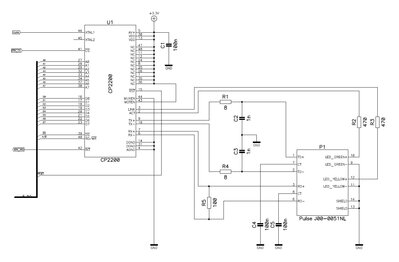

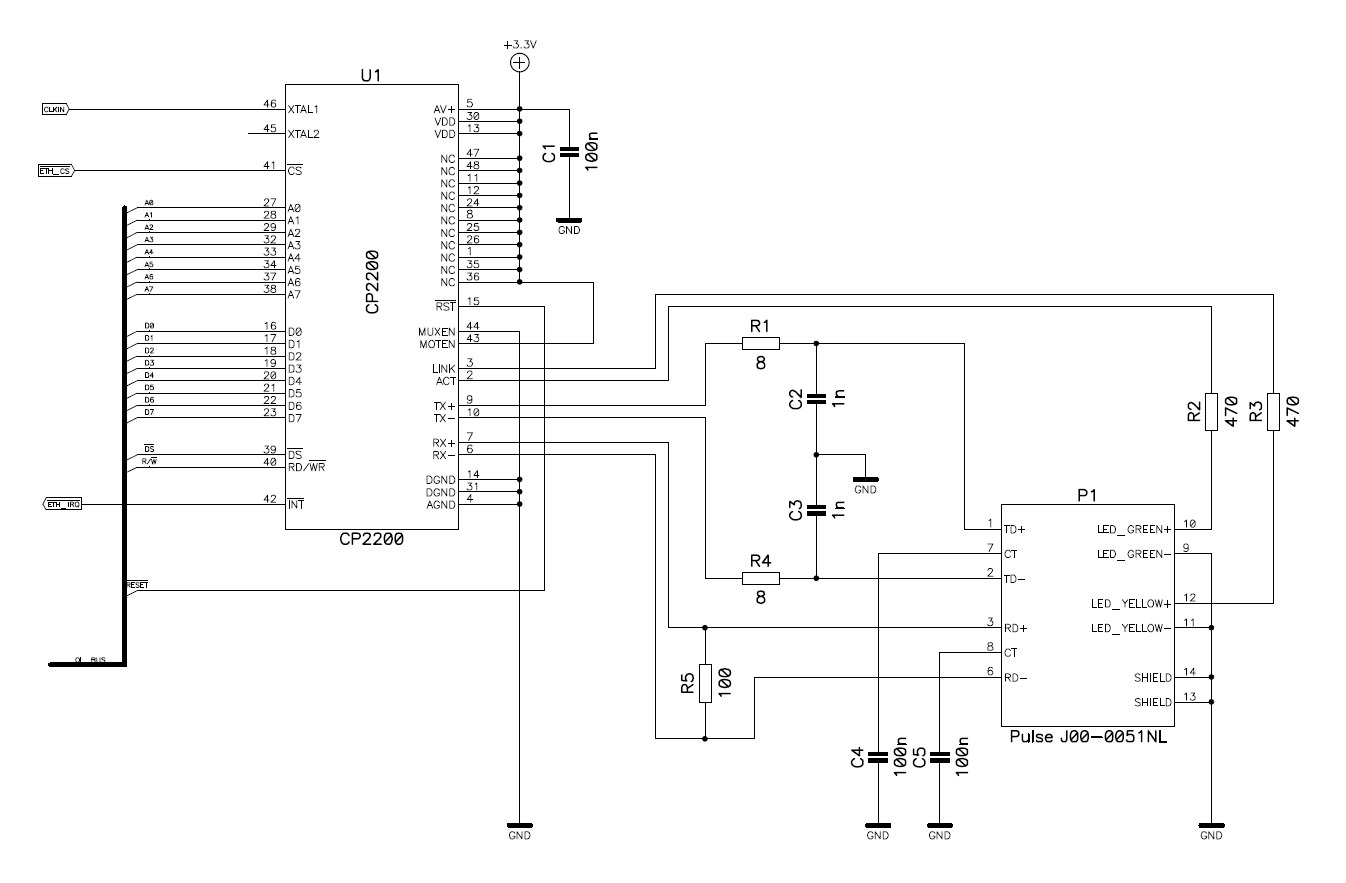

in the past, ethernet for the QL has been discussed here quite a lot. Now that Martin's ethernet driver for the Q68 has arrived, see viewtopic.php?f=3&t=3578, I think it is a good time to provide information and schematic sources here to help others building the equivalent hardware for an original QL. I think it has become practical now - unless all who are interested in ethernet have or want a Q68 anyway.
I chose the CP2200 ethernet controller for the Q68, because it also interfaces very easily to the original QL bus. Firstly, all signals are 5V tolerant. Secondly, it has a non-multiplexed 8 bit data bus, requiring no serialization. Thirdly, it requires only address decoding, no further logic to interface directly with the QL bus. Please find below the priciple schematic, based on the working and tested Q68 circuitry:
Explanations:
  • The CLKIN signal has to be a 20 MHz clock.
  • The /ETH_CS signal needs to be generated by an address decoder, which is specific to the project into which ethernet is integrated. For a stand-alone extension this could be a GAL.
  • The /ETH_IRQ signal has to generate a level 2 interrupt for the QL. There is a specialty here, inasmuch the CP2200 activates the interrupt line on power-up. If possible, it should be deactivated by software before interrupts are allowed for the CPU. If this is not desired, as it requires a (minimal) ROM change, a hardware register should be added in the external logic which gates this signal.
The only change to make the Q68 ethernet driver work for a QL is probably the address space. At least a memory expansion is required for the driver. And keep in mind the QL is a slow machine. Less than a Gold Card system would result in data rates only moderately faster than QL network. If someone wants to design a CP2200 card for the QL, please feel free to ask questions. I think this could also be interesting for Tetroid if he designs new (S)GC clones.
All the best

INT could be gated by a control signal from a flip flop - the flip flop could be reset at startup (cleared by /reset signal from QL) and not allowed until both an access to the CP2200 address range AND the CP2200 INT line being high (in other words a suitable control byte has been written to clear INT status internally within the CP2200) A status read or something similar maybe required after the /INT line is allowed to set the flip flop

I presume a 20MHz crystal could be used across both XTAL lines on the CP2200, or an external oscillator can with TTL output ?

I wonder if an expansion card could be made for a standard QL, it would probably need sort of ram expansion.
Maybe the Qubide Ram card could be modified to have Ethernet integrated into the circuit board. I say this as the circuit board schematics are available.

Pr0f wrote:INT could be gated by a control signal from a flip flop - the flip flop could be reset at startup (cleared by /reset signal from QL) and not allowed until both an access to the CP2200 address range AND the CP2200 INT line being high (in other words a suitable control byte has been written to clear INT status internally within the CP2200) A status read or something similar maybe required after the /INT line is allowed to set the flip flop
A creative idea! :) I thought of a register with separate address, but this is more elegant.
Pr0f wrote:I presume a 20MHz crystal could be used across both XTAL lines on the CP2200, or an external oscillator can with TTL output ?
Yes, both is possible. On the Q68, I used an oscillator.
Derek_Stewart wrote:Maybe the Qubide Ram card could be modified to have Ethernet integrated into the circuit board. I say this as the circuit board schematics are available.
I'm not sure which exact card you mean, can you post a link maybe?
Ideally, the solution would also allows an (S)GC. I didn't have an idea how this could be done, except with a backplane.
