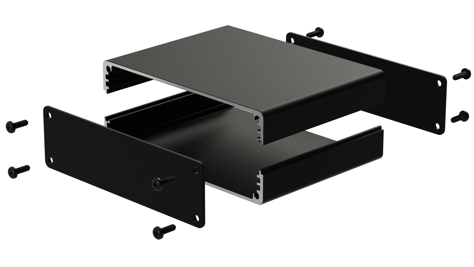

I would like to keep the original case size, but there is no room for the QL Netork Connectors on the Back Panel.
I have produced a solution, where the 2 x QL Network connectors are located on the side of the case. This requires 2 x 6mm holes drilled in the case wall, with 8mm counter bored holes to suit the Connector securing nuts.
Inside the case some of the metal case wall is required to be removed to accomodate the QL Network connectors.
These operations are fairly straight forward, for one or two cases, but 20 plus requires more alot more time and effort
The alternative is to use a case of the same profile, with a increased height of 15mm. So that the extra QL Network and maybe I2C connectors can be be located on the back panel.
I will have get a prototype made to see if it looks OK

Here is another option for the current case: This is he same dimension as the previous case, except it is split into 2 halfves, allowing the top half to be removed allowing the Q68 board to accessed fitted n the lower half.
The advantages of this design are: Easy installation and access to the Q68 board, without removal of the Q68 PCB from case, uses same end panel design.
The only disadvantage is the plan design of the case.

I am in the final stage of case design. The new case and panels have been designed and ready to be fabricated.
I am looking to have the I2C and QL Net connectors on the Rear Panel.
I was going to fit 2 QL NET 3.5mm connectors, there does not seem enough space for 2 QL NET connectors, but 1 QL NET Connector could be fitted.
Is 1 QL NET Connector a limitation on connection to a QL Network?
An alternative would be to have a extension cable with the 2 QL NET Connectors outside the Q68 with a connection on the Resr Panel to the Q68 QL NET connections.
