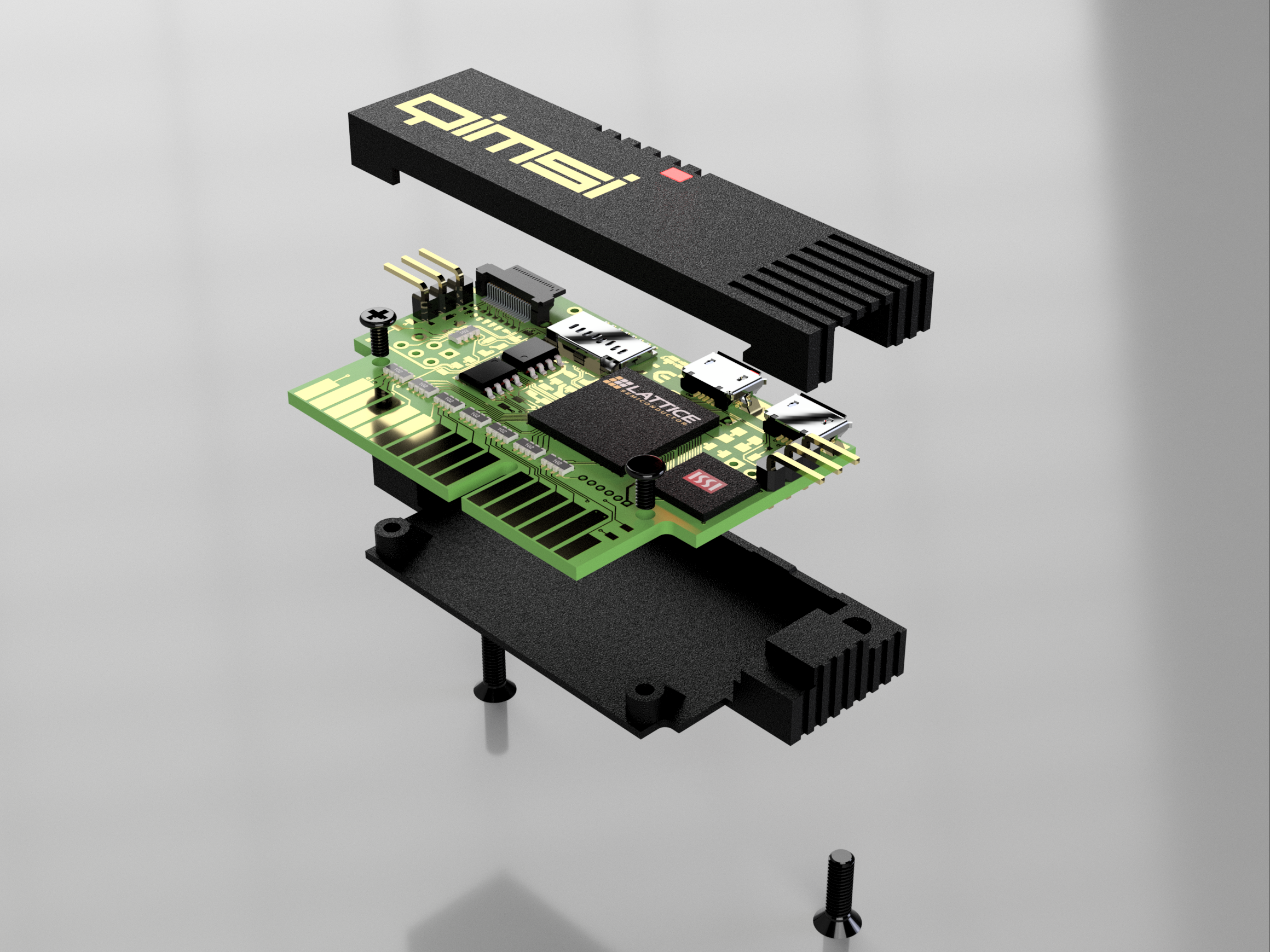

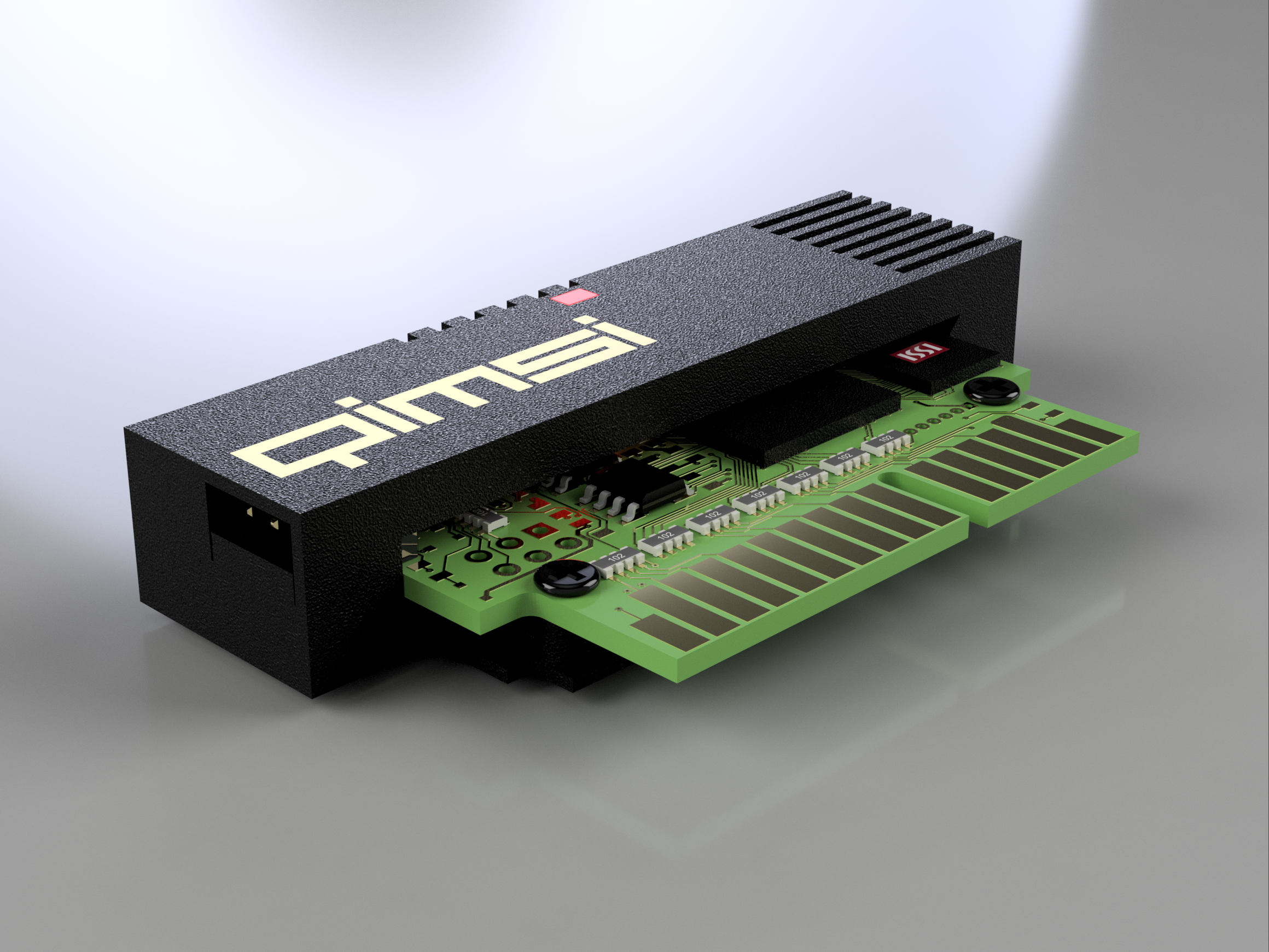

I found some nice designs online for an enclosure, but what I was missing was the option to be able to access the serial port and I/O without removing the enclosure. So I added slots on each side which can hold standard 3-pin Dupont connectors. For that you have to solder in two right angle pin headers as shown here:
Exploded view
Exploded view

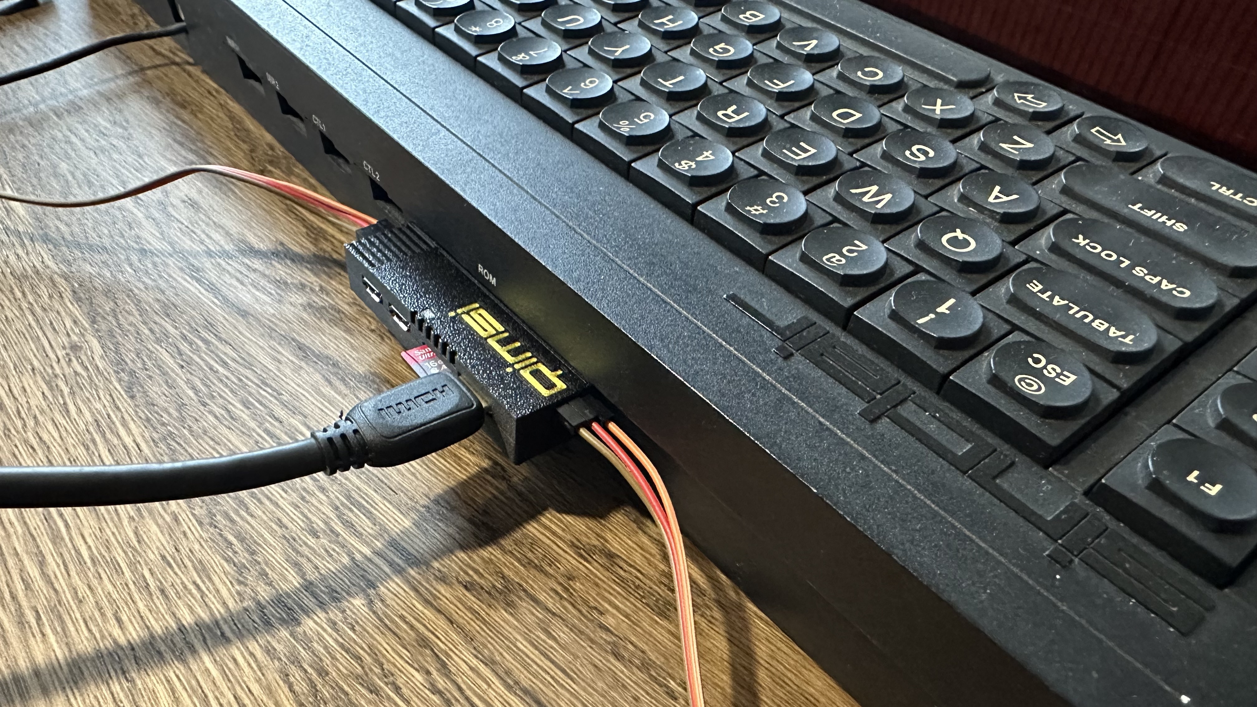

Here are the cables plugged in:
Dupont connectors
Dupont connectors

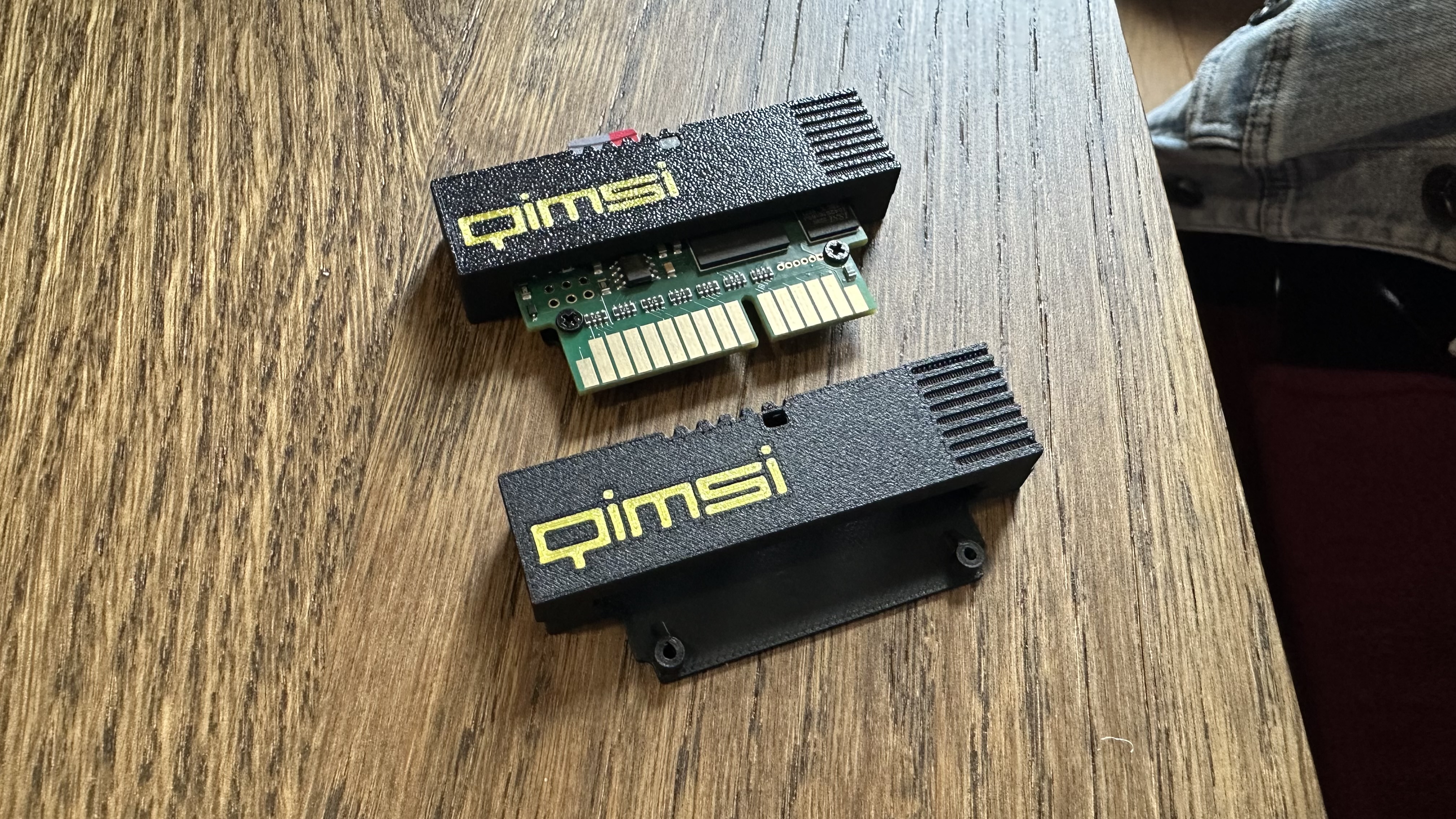

Tried to mimic the looks of the QL. Thanks to the late Rick Dickenson for his wonderful work.
Assembled
Assembled

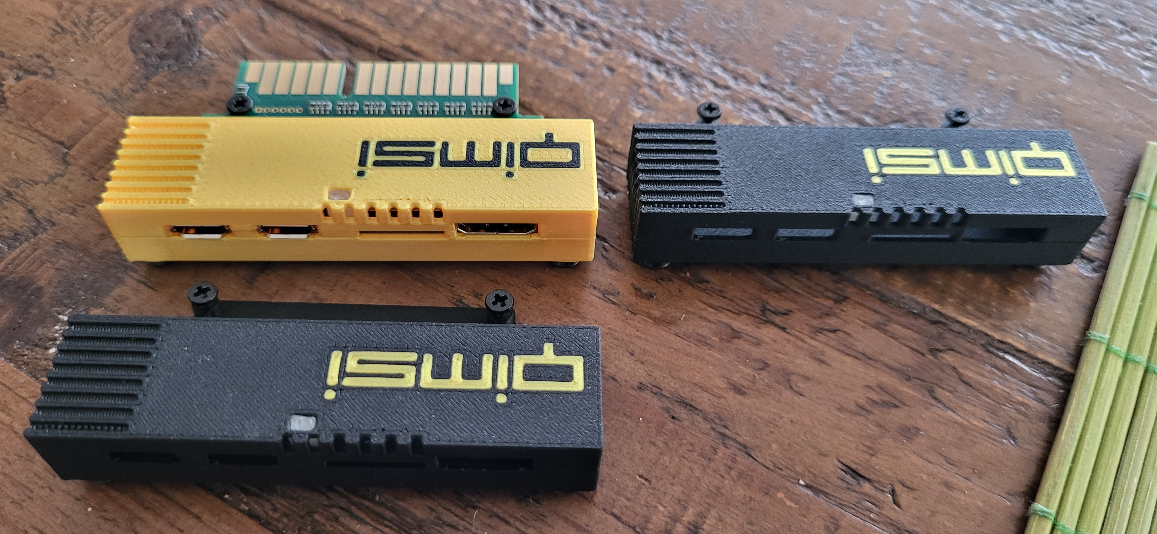

I tried several build plates to get a nice matte textured finish and what worked for me is PLA-CF on a CryoGrip Glacier Pro build plate.
And of course PLA Silk Gold for the lettering! ;)
PLA-CF and PLA Matte

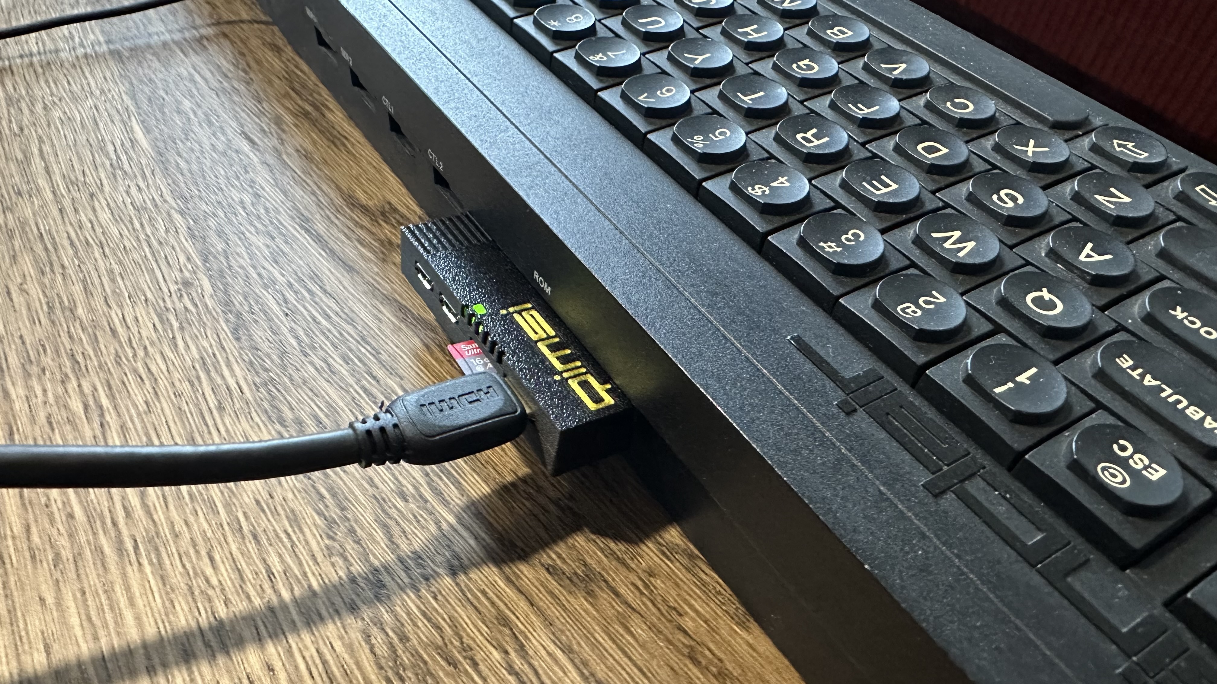

There is a tiny light pipe in there as well. Can be omitted as the LED is quite bright. But it looks a bit more diffused this way. Printed in natural PLA.
Light pipe
Light pipe
