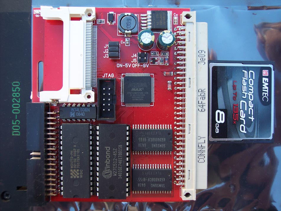

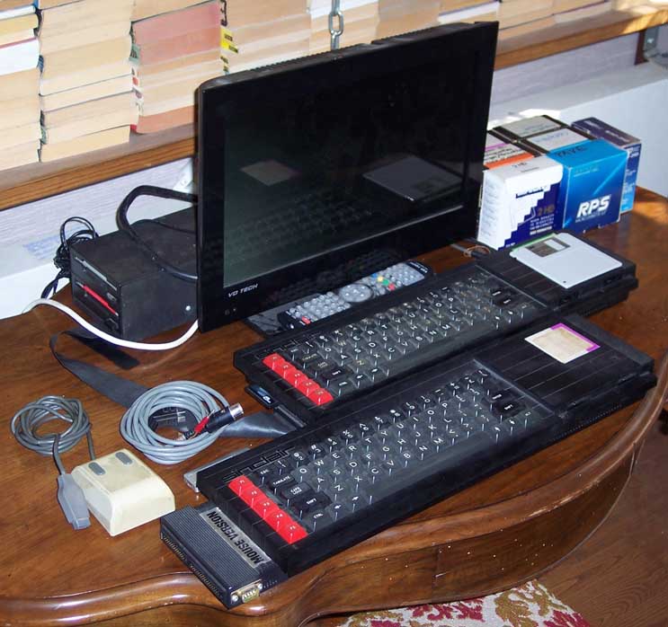

Hi all,
I told you already when I joined this forum that I have 2 QLs (one that I bought end 1984 - when they first arrived in France - with a JM ROM, and the second - for spare, when Sinclair sold out the last ones - with a JS ROM.
To the first one I soon added a Sandy SuperQboard - later upgraded to support a mouse - and TK2 ROM, 512Kb RAM, floppy interface and parallel printer interface. The second one remained boxed.
Lately, for my second QL I bought a Tetroid extension adding to it TK2, 768Kb RAM, a floppy interface and a 8Gb CF card.
By the way, I have a question (for those who may know) : what is the use of the (undocumented) "JTAG" connector in the middle of the board
To have it work, it was actually not so simple - but I managed :
The Starter Kit provided by Alain Haoui was very helpful to me as a good example of how to initialize and partition the CF, but his setup program creates only two small partitions. I still do not know exactly how I will use this huge mass store, anyway here is my first (modifiable) personal partition plan for the whole space :
First partition named "GIRL" will be of 60Mb with 8 sect/block, dedicated in principle to WIN1 channel. Needing 60Kb of RAM space for the FAT.
Followed by eight partitions of same size and organization called "BOY2" to "BOY9", swappable in principle to WIN2 channel using an additional 60Kb of RAM space for their FAT.
In the remaining CF card space, I will create 20 bigger partitions, that may be used occasionally (for what ?), swappable to WIN3 channel.
Partitions 10 to 19 will be called "CAT0" to "CAT9" and will be of 240Mb with 32 sect/block, thus needing when WIN3 is used, 60Kb more of RAM for their FAT.
Partitions 20 to 29 will be called "DOG0" to "DOG9" and will be of 433Mb with 32 sect/block, thus using up to 110Kb of RAM for their FAT.
This provides for all 8Gb but 7 "tracks".
With this in mind, I rewrote completely the setup_bas program and did it more in the spirit of SuperBasic : defining procedures !
Commented listing :
Final notes : the line numbers I put are suited for merging this file to an existing boot of a floppy. And these tools do not do error checking, either I will add them later, or I will decide that they will be used so scarcely that error checking is not needed. As I intend also to modify the file for booting from WIN1, I may add more secure versions to it.
May the FORTH be with you.
Bye Paul
Commented listing :

You asked "what is the use of the (undocumented) "JTAG" connector in the middle of the board"
As I understand it, the CPLD (or FPGA) that Tetroid has designed at the heart of his expansion card can be re-programmed 'in-place' via the JTAG connection and a suitable programmer/cable. It spares you from having to remove the device and fit it in to a separate programmer in order to re-program the 'firmware.'
Its only likely to be of use to you should Tetroid release updated firmware for the device - perhaps to address any bugs that might come to light in the future (e.g. like Marcel has devised for his updated QL-SD interface). It's not of immediate value to the end-user as the firmware of the programmable device is inherently tied-to the design of the rest of the interface.
Just to be clear, 'firmware' here is used rather loosely and has nothing to do with the 68k code contained in the ROM that is accessed by the QL itself.
Perhaps more value will be gained by playing with the hardware as it is today - you've got some very nice equipment, after all!
M.
Nice set-up!
M.
