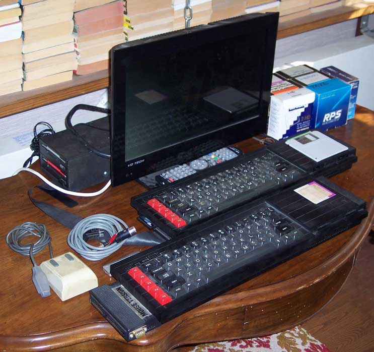

Hi all,
I told you already when I joined this forum that I have 2 QLs (one that I bought end 1984 - when they first arrived in France - with a JM ROM, and the second - for spare, when Sinclair sold out the last ones - with a JS ROM.
To the first one I soon added a Sandy SuperQboard - later upgraded to support a mouse - and TK2 ROM, 512Kb RAM, floppy interface and parallel printer interface. The second one remained boxed.

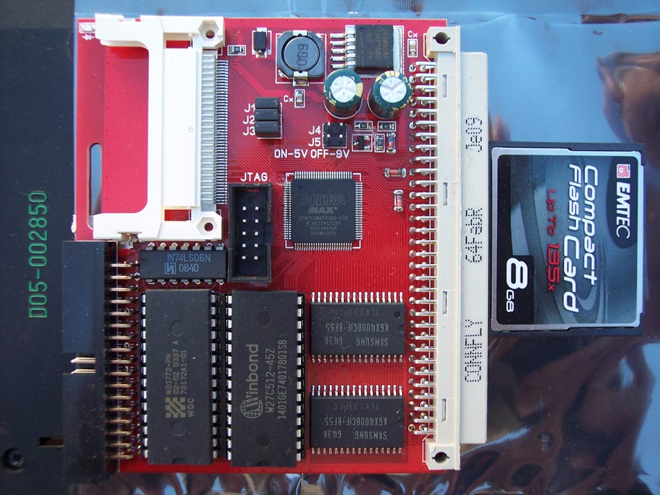

Lately, for my second QL I bought a Tetroid extension adding to it TK2, 768Kb RAM, a floppy interface and a 8Gb CF card.
By the way, I have a question (for those who may know) : what is the use of the (undocumented) "JTAG" connector in the middle of the board

martyn_hill
Posts: 1126
Re: Overview of QL SD / CF Solutions
Post by martyn_hill »
Hi Paul
Nice set-up!
You asked "what is the use of the (undocumented) "JTAG" connector in the middle of the board"
As I understand it, the CPLD (or FPGA) that Tetroid has designed at the heart of his expansion card can be re-programmed 'in-place' via the JTAG connection and a suitable programmer/cable. It spares you from having to remove the device and fit it in to a separate programmer in order to re-program the 'firmware.'
Its only likely to be of use to you should Tetroid release updated firmware for the device - perhaps to address any bugs that might come to light in the future (e.g. like Marcel has devised for his updated QL-SD interface). It's not of immediate value to the end-user as the firmware of the programmable device is inherently tied-to the design of the rest of the interface.
Just to be clear, 'firmware' here is used rather loosely and has nothing to do with the 68k code contained in the ROM that is accessed by the QL itself.
Perhaps more value will be gained by playing with the hardware as it is today - you've got some very nice equipment, after all!
M.
