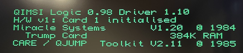

Re: Floppy Drives with TrumpMini3 Woes
This is what the screen looks like after a res_384 on a JS with original Trump 768k
With MTC3 only the QIMSI lines appear

I copied the ROM from the original TC to MTC3 and the card still vanishes on a res_384 or whatever, so not ROM relatedt0nyt wrote: Mon Aug 04, 2025 7:24 am This is what the screen looks like after a res_384 on a JS with original Trump 768k
Thanks
Tony
