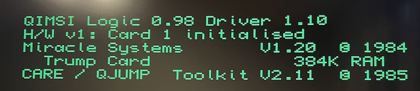

Re: Floppy Drives with TrumpMini3 Woes
This is what the screen looks like after a res_384 on a JS with original Trump 768k
With MTC3 only the QIMSI lines appear
