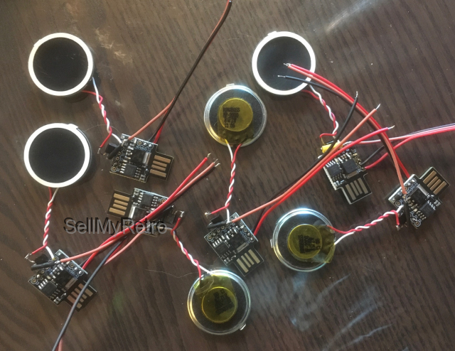

stephen_usher wrote: Wed Jun 24, 2020 10:08 pm A conversation on the QL Facebook page got me wondering how easy it would be to get the digitised sound of a microdrive running to play when the vDrive was accessed.
A long time ago I bought Johan Engdahl's little device to add sound to my vDrive. I sounded pretty bad:
https://youtu.be/JbBH4GgZxsM?t=466
Is there a way to reprogram that device (it has a USB connection) with your code? I recall seeing a YouTube video of yours where the sound was perfect.

bwinkel67 wrote: Mon Jun 02, 2025 2:33 am
Ah!
Yeah! For that reason I have posted in your video. So it was you :)
I think it is not due to programming (or it is),
I am trying to convert that sharp thing based on freq into a wave (DAC) with some caps an resistors in order to make the curves restructured.
Not easy (long time without doing something like that, decades probably).
Just I wanted to be sure it was not my mistake, and now with your feedback and others (recently some also told me unsuccessful same goal).
By now it is only 1 person seems to got it. Thus he has the key.
Also I was studying the schema... it seems to me to do not be right, the capacitor is between +5v and +5v? I think it is a typing mistake. The signal is a square, no way it could be a digitalized sound, but perhaps that would be my mistake (for a fuse or who knows thing, that I couldn't reprogram).
The Attiny takes more than 10 seconds (with my board Digispark or direct powered) to start the sound, not usable at all, in 10 seconds the microdrives has finished the reading, so led activity.
In any case, it has a lot of lack of info.

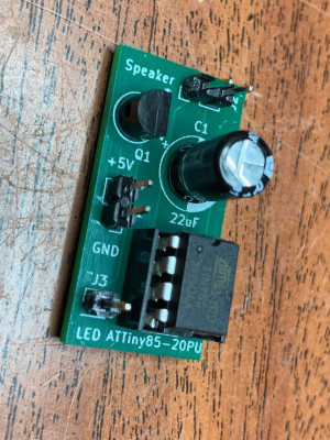

stephen_usher
Posts: 582
Location: Oxford, UK.
Re: vDrive: With MDV sound? I wonder.
Post by stephen_usher »
I don't have a "Digispark" ATTiny, I just use a DIP Atmel ATTiny85 chip. The LED output turns on the transistor which regulates the power to the chip, so the ATTiny85 chip powers up and starts working almost instantly.
This is the version made with a proper PCB.
Here's it in action, and it shows the speaker in more detail (Sorry about the half coughs, I had bad hay fever at the time.): https://youtu.be/A9s6XKbfVUY?si=YxysALuTFVFqtwi0

Do you have Gerber files to make more PCBs
stephen_usher
Posts: 582
Derek_Stewart wrote: Mon Jun 02, 2025 4:25 pm Hi
Yes, on the github repository: https://github.com/stephen-usher/vDrive-Sound-Board
