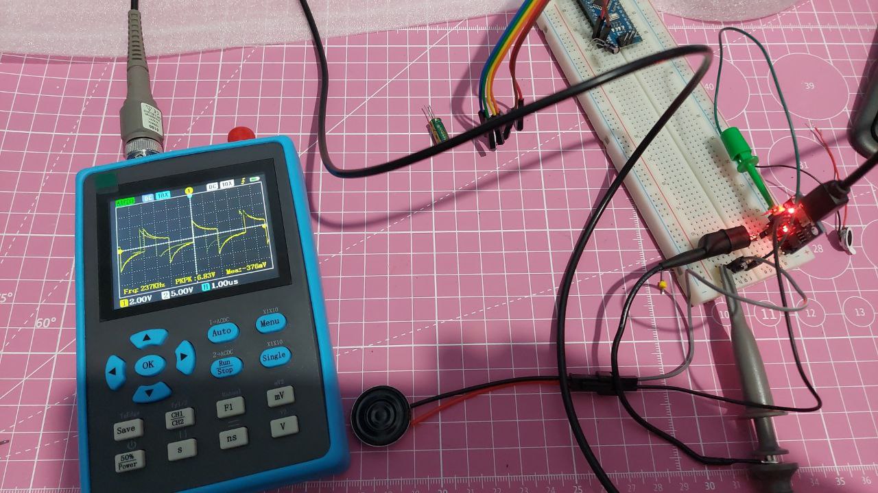

Hi again!
Play around with the Digispark board with Attiny85, the sounds that I get is very metallic and annoying.
Could you tell me which speaker did you use to get this sweet sound?
Did you add a capacitor to the speaker?
:) thanks again

The signal is too sharp,
With a capacitor it becomes a little softer (and of course higher) but that's all.
And another question,
I am using for testing the Attiny85 within Digispark board, once I power it up, it takes about 10 seconds to start playing the sound, not immediately as it supposes to do.
Is it normal? too long time to start it attached to the activity led. Isn't it?
