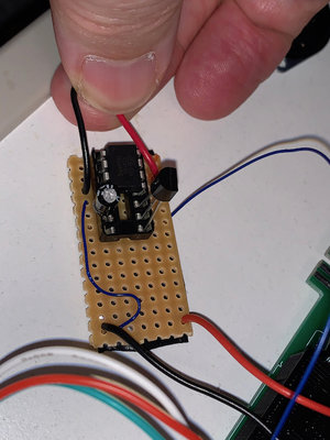

I've built the first version of the sound unit today and it does actually work.
The card itself fits nicely under the SD card holder.
