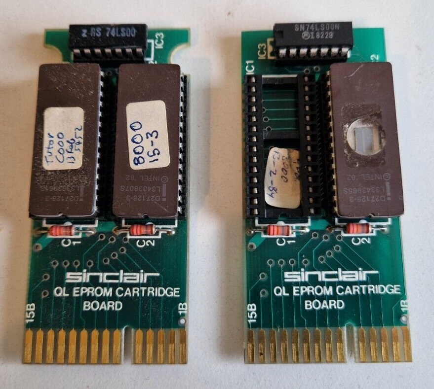

Yes, it would make sense for the ROM there to be for debugging: The TUTOR keyword disables interrupts and jumps to $C000, and unused CPU exception vectors also jump to the $Cxxx area.

Here's another picture from the ebay listing for the dongles. It shows a 'TUTOR' ROM marked C000, so that makes sense, whatever Tutor was/is.
So the question is, can this be made to work to any degree without the original 8000 ROM? Lacking some features, but some kind of stable environment?
