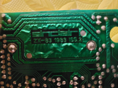

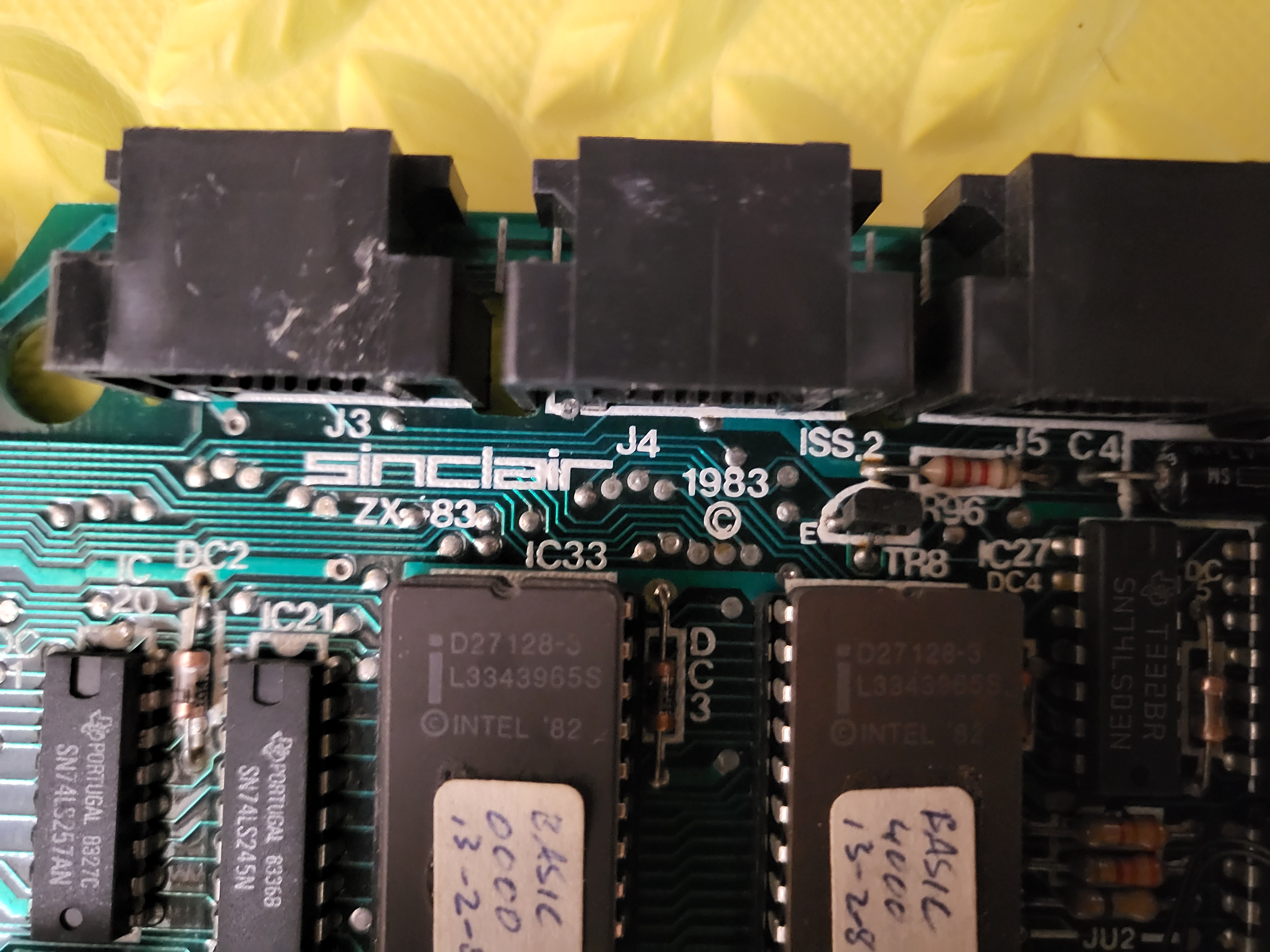

Hi all,
After wanting one for a while, I've finally bagged a QL! On inspection it appears to be a very early model (no serial number stamped, ZX83 marked PCB 1983, issue 2).

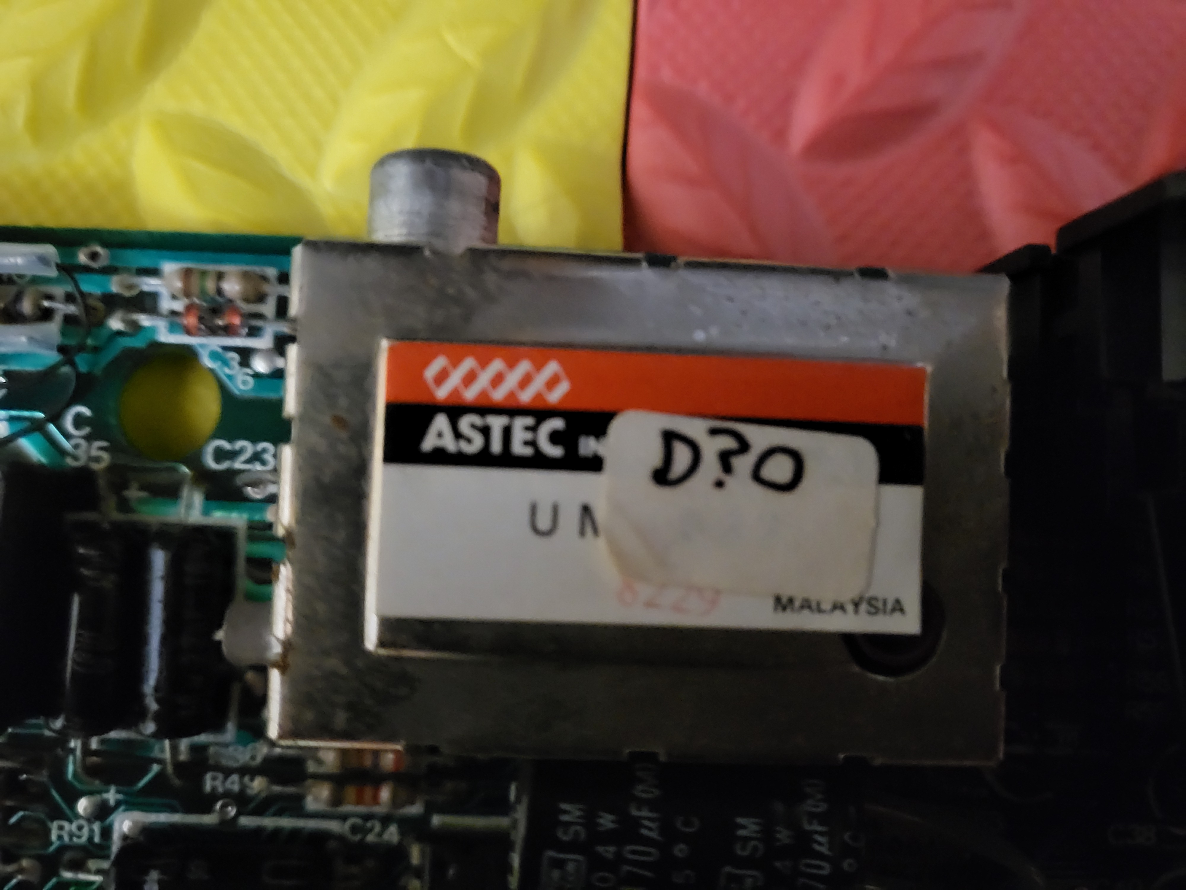

Not sure of exact manufacture date, but it had 'D?0' stickers inside. It also had some stickers dated 13.02.1984, and the membrane was dated 16.01.1984.
The case and keyboard is in pristine condition (it was dirty but gave it a thorough clean). On the micro processor chip there was a label with 'Blown' written on it, so hopefully this is the only thing wrong!)

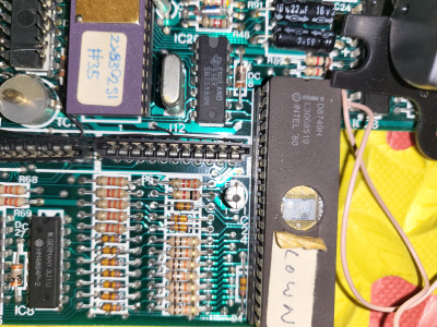

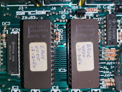

It looks like it has the 48k ROM, I know the early ones had a dongle - Intel part numbers D72128-3 - would anyone be able to advise?

Re: New QL user & owner
Do you mean issue 5? I don't think there was an issue 2.
And the ROM, is it a D27128-3? With a window and usually tape stuck on it? If so, that's a normal UV erasable EPROM.
Post some pics. That should make it clearer. Lack of serial no. doesn't necessarily mean it's an early one as I think they were known to sometimes use bottom cases with no serials numbers and sometimes just a sticker.
Wow, it is an issue 2! I've never seen one. Is indeed very early.

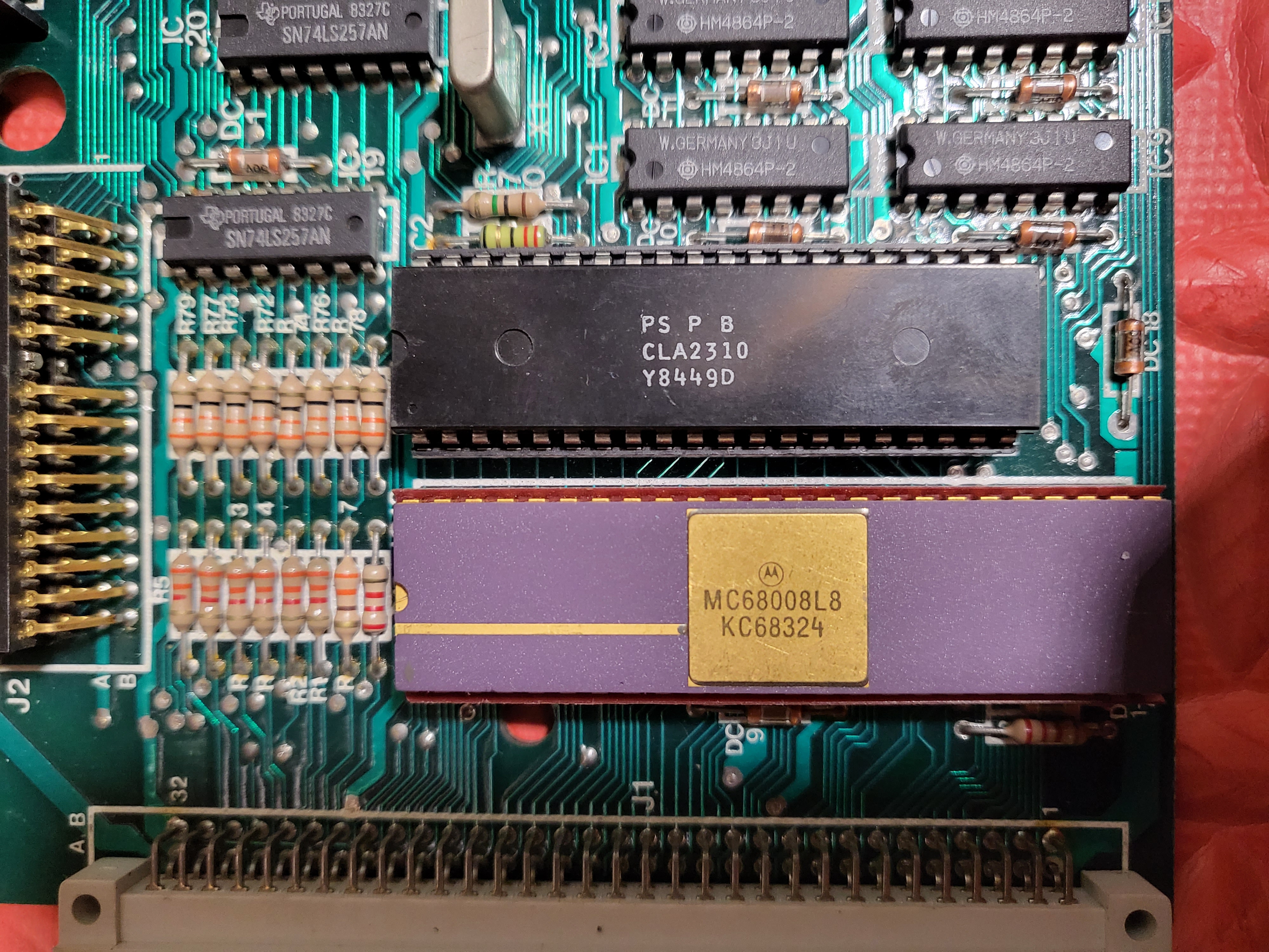

What does the CPU and chip next to it look like?
Extra photos attached, just waiting for a scart cable to arrive to see if it all works (my TV would not tune in to the RF).

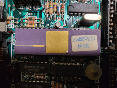

Personally I think that early QL is so collectable that it should be left exactly how it is (and in an ideal world, sold to me)
I wonder if that ZX8302 is actually number 35.
The top case part, at the back on the microdrive side, does it lack the vent holes that were added later for cooling?
