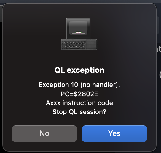

Thanks Jan, that let's it compile (apart from timertick's "add.l #MSPERTICK,ticksMillis+8(a6)" which I've commented out until I can work out what's missing)
Currently the emulator keeps crashing, I think each time the handler is called. Perhaps related to the above missing line?

Interesting, you managed to jump to a system variable (SV.RAND) which contains a random number... And by chance it happened to have a value $Axxx which is always illegal to the 68000 (but often used by emulators).
Posts: 3167
Re: Joystick/Sound in Supervisor mode?
And you managed to bring up a message window I've never seen before :) . (Didn't know Q-Emulator catches Line-A traps)

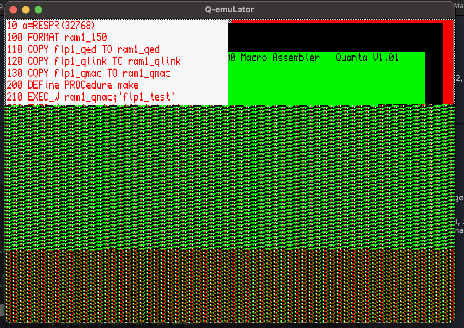

Well the error message has gone for now and I just get a corrupt screen
I've now stripped out all my code to just leave the timer routines which still give me a corrupt screen
         section  code
         lea.l    0(a6,a4.l),a6
         jsr      timerInit
loop     jmp      loop

I'm obviously missing something really simple here

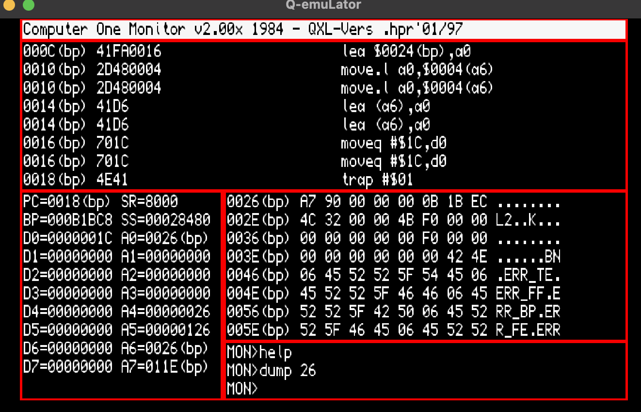

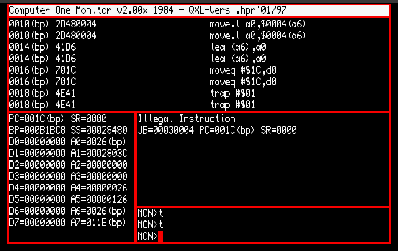

Have tried tracing with C1Monitor and I can see that the data section is indeed located directly after the code ends and is in A6, so that all looks ok
But as I trace when it does the TRAP #1 it raises an illegal instruction
EDIT: After the illegal instruction the following rts is skipped, don't know if that's just a quirk of C1Monitor or if it's actually happening

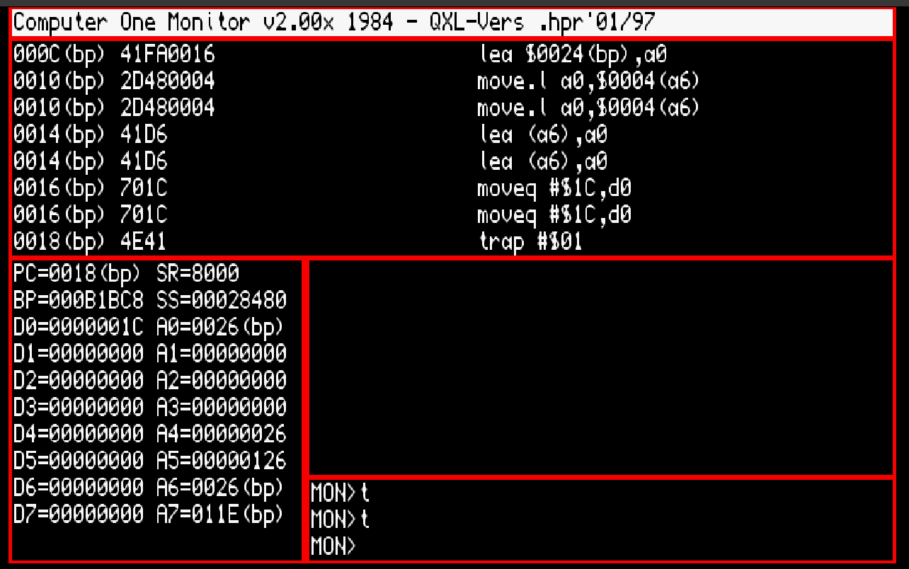

This is C1Monitor immediately before the TRAP 1 tries to execute

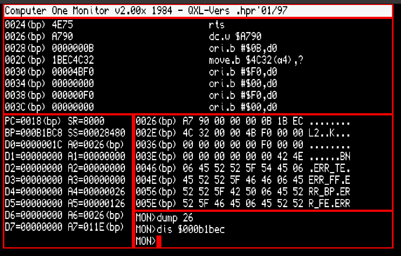

A dump of the storage and a disassembly of what it points to (rts)
I mean it all looks ok so I don't understand why it collapses in a heap
