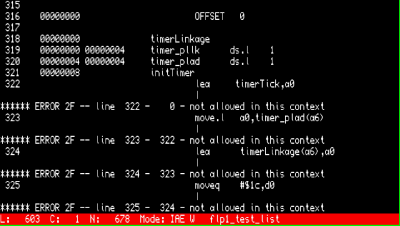

Thanks Tofro, so "OFFSET 0" puts the code at the start of the 4kb?
It still won't assemble code after an OFFSET though (the offset section is at the end of my source file)
