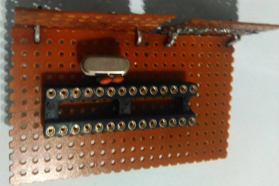

The burnt left hand joint of the three on the ribbon PCB looks cracked but it could just be a ring of flux. For comparison here is a picture of my work in progress single PIC keypad interface that should do the same thing. t will be serial first but could do PS/2 with a software change if it works as designed. :) Amazing how technology has changed.

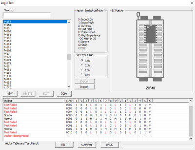

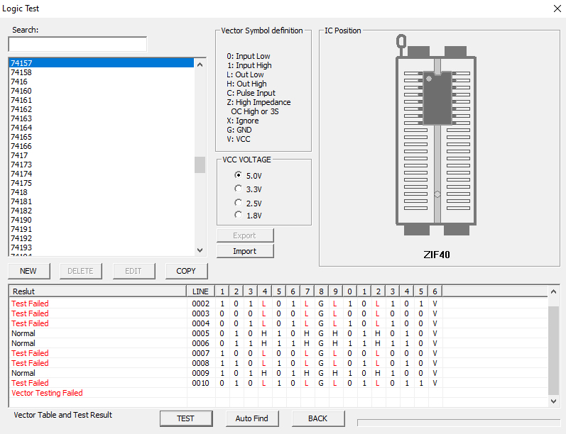

I've removed all the chips now and the 2nd 74HC157 was also faulty. Both were RCA branded. Perhaps that was causing the lockups. Or maybe they didn't like the heat from de-soldering.
Currently 3 chips are removed, I need to fit sockets and replace the 157 before checking it again.

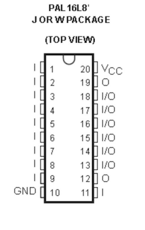

I've just been looking into it further, examining the Retro Chip Tester instructions (which includes a handy example for a PAL16L) and I've made a little progress. What I haven't yet been able to ascertain 100%, is which pins are outputs and which are inputs. The example in the RCT manual talks about a chip with the following configuration:
Pin Type
1 Input
2 Input
3 Input
4 Input
5 Input
6 Input
7 Input
8 Input
9 Input
10 GND
11 Input
12 Output
13 Output
14 Output
15 Input
16 Input
17 Input
18 Input
19 Output
20 +5v
But what I haven't yet worked out... is that the same for every PAL16L chip, or could I have different pins for inputs/outputs? If it's likely to be different, then I assume I have to follow traces, buzz each pin etc, find out where it goes and from that info, work out which is an Input and which is an Output?
Anyway, if the above I/O list is correct, then this attached file is what I have so far.
Edit: Ah, so by the looks of it, only pins 13 to 18 can be either I or O, right? So I would just need to investigate those?
