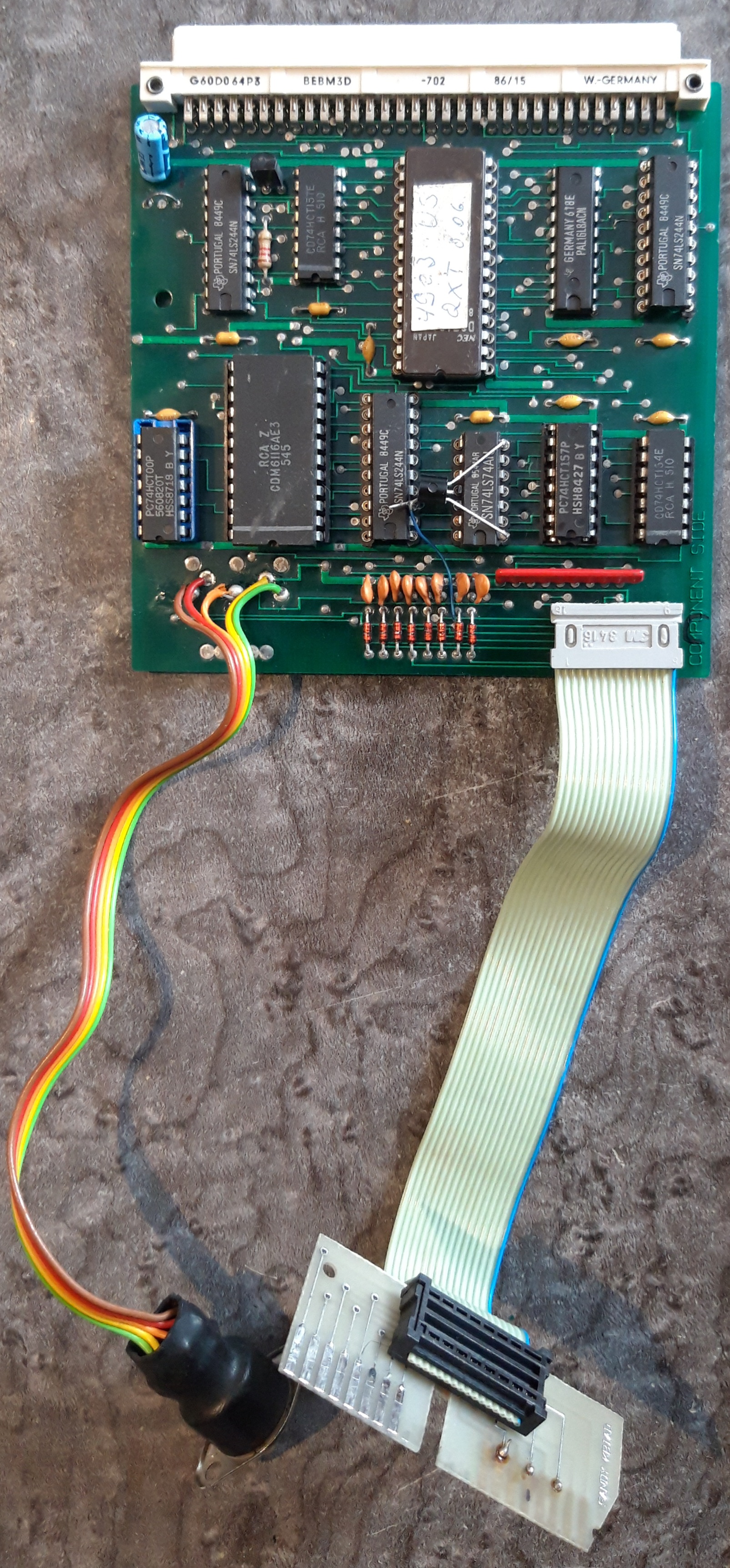

I've put this in a separate thread because it will get lost in my QXT640 thread.
If anyone else has this same Sandy k/b interface that works I'd love to compare notes and get a copy of your ROM data, as my device doesn't work and it would be nice to confirm the ROM. I've attached a dump of my ROM, v 0.06 (note most of the ROM is blank, it seems to just use the top approx 2k).
The same interface is also shown on the wiki at the bottom of this page:
https://qlwiki.theqlforum.com/doku.php?i ... _interface
I note that that one has some kind of meaty capacitor across 2 of the connections to the AT keyboard. Mine has a transistor mod added, which I think is probably an attempt to rectify whatever issue the capacitor was for.
My issue: With the device plugged in the QL will not boot from power-on, but does boot when then reset. Then a ROM message appears on screen as expected. None of the keys produce the character that they should produce, some produce 2 characters and after a short time the QL locks up. With the connection to the QL k/b connectors removed, it's the same behaviour, so it seems the k/b connection isn't doing anything.
I've checked and reinstated some broken connections. I also discovered a bad 74x chip yesterday and replaced it. Nothing seems to make any difference. For testing I'm using an old known working AT keyboard, but I've also tried a couple of PS/2 keyboards with convertors. Always the same issues.

Yes, the previous remark about making it PS/2 friendly is why I was using a real old AT keyboard. I suppose that may not be compatible somehow, perhaps it's fussy with AT keyboards, although the k/b works fine with all manner of old PC motherboards (and it can be switched to XT mode, so also works with an XT). In fact, I could also try the same k/b in XT mode.
As for the boot from power on issue, it only ever happens with this card attached and it happens on JS too, but on JS the screen is simply blank. Just on Minerva the logo appears bottom right and it gets stuck there, unless you reset in that state. Without the card, the QL behaves as it should.
The screen ROM message definitely comes from this card, it shows the QXT Upgrade v0.06 message that also appears in the ROM code.
Be nice to get it working to eventually reverse engineer and then use as a QL to PS/2 interface.
