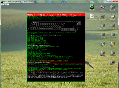

On qle_cfg what settings do I put it on to have all the Apps and games but just QDT not QLE OK thanks Simon Foster

Yes, the easy way is to use the QLECFG program. See seperate thread. With the use of QLECFG you can get a pretty clean QDT Installation running on QL/E. See attached screenshot. All that in seconds, and without having to change a single line of program code.
