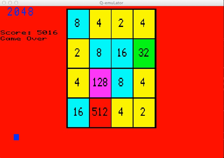

Mr_Navigator
QL Fanatic
Posts: 782
Location: UK, Essex
Re: New game for the QL
Post by Mr_Navigator »
Screen Shot

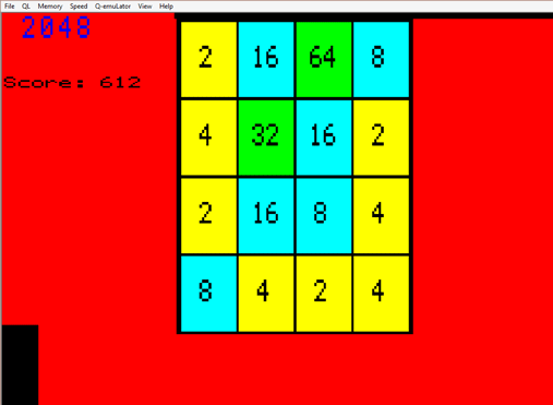

Yes, it's cool and addicting :?
Screenshot of my first try ...
Good job !
