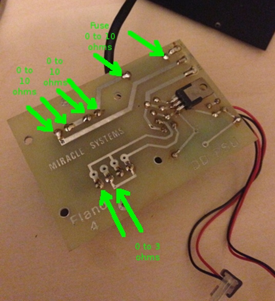

I had a look around this tonight, unless I am just a useless software engineer, I would say that 1 of the primary winding has gone and 1 of the secondary as they appear to be open circuit.
240v AC going in, nothing out of the transformer. I am assuming it should be 18v, regulated down to 12v.

1024MAK
Posts: 593
Re: Miracle Systems Floppy PSU
Post by 1024MAK »
Looks fixable to me :mrgreen: (normal get out clause may apply :P )
With the unit unplugged you are looking to see low resistance readings (from zero ohms to about 10 ohms max) across the fuse, the primary windings and the secondary windings. Check to see if the board has been coated in a protective coating (as this will act as a layer of insulation)As per picture:
If you are getting open circuit (sometimes shown as O/L for over load on the meter) or you get very high readings, then the transformer has died. Although transformers (in general) are normally reliable.
Replacement transformers can be obtained, the only problem being the pins may be in different places.
If the transformer is okay, we can move on to the next step.
Mark

skagon wrote:Yikes!
Transformer, rectifier bridge, shitty capacitors, 7812, no filtering?
Looks more like the rectified 9V ac from the transformer is smoothed by the large blue electrolytic capacitor, this the feeds the +12V dc supply to the FDD (but off load will be about 13V). Meanwhile this supply also feeds a 7805 voltage regulator, which in turn feeds a regulated +5V dc supply to the FDD.
State of the art, it is not, but it does the job.

Mark, I had a second look, I don't think you're right mate.
The only thing I was wrong was the 7812; it's probably a 7805. The output from the transformer goes through the bridge and then directly onto the 7805. The big ass capacitor is between ground and bridge positive, and the two smaller ones are between ground and 7805 in and out.
The drives are obviously +5V only models.
Does the job, sure but... designs like that I wouldn't really trust for anything important.
