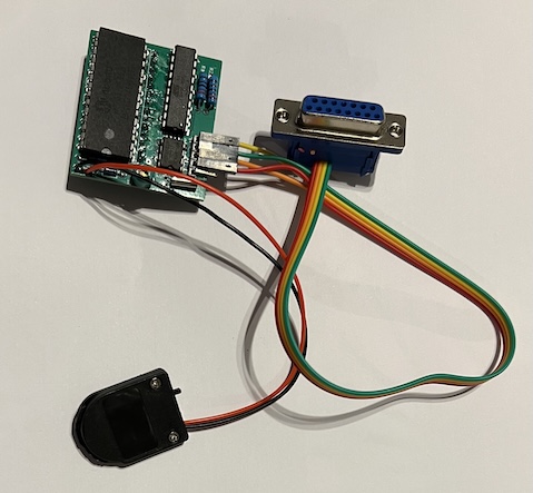

A remake of the Minerva Mk2 (I'm using 15 pin D connectors for i2c to maintain hardware compatibility with my BBC Model B's i2c)

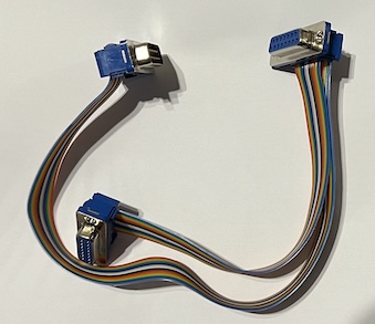

A 2 x device harness

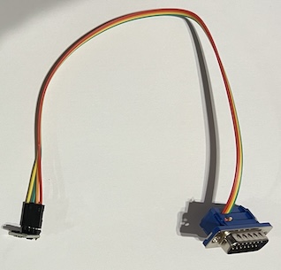

A harness for attaching a device to the 2 x device harness or to the Minerva Mk2 (with an HTU21D attached)

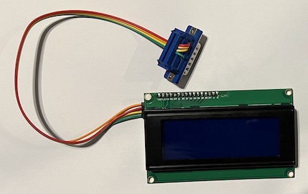

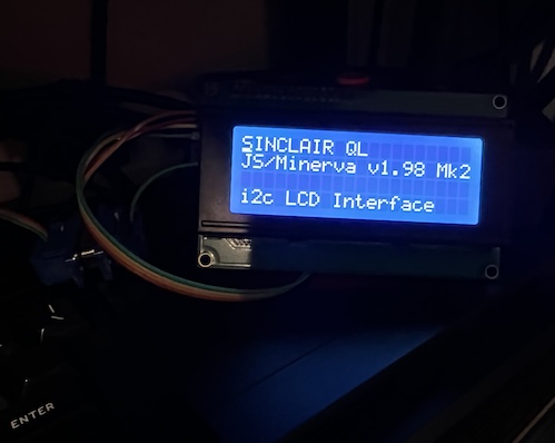

There's a multitude of i2c LCD displays so I chose a simple 4 lines x 20 characters as my first i2c device to try
Having blatantly copied the code by MartinB on StarDot it proved to be straightforward, so I assume other displays will hopefully be just as simple (maybe not the matrix style that I've not tried yet)

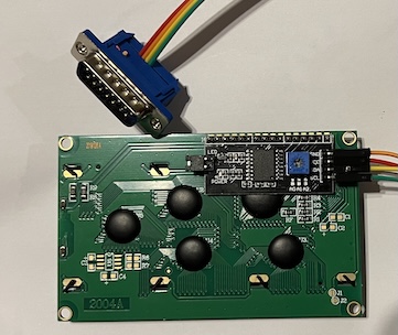

A typical 4x20 LCD (with harness attached)
The reverse shows the PCF8574 GPIO extender board for the i2c (mine is a TI version with ID &27 for I2C_IO, NXP's use &3F)
The TI version Datasheet specifies it can use 8 x I2C addresses &40/41 thru to &4E/4F
A simple basic test program
Example output

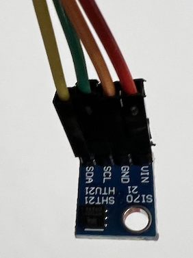

Next up was an HTU-21D Temperature/Relative Humidity sensor
Device id from Datasheet is &80, use &40 for I2C_IO
This was the first device I tried where information was being read back and it proved to be a difficult learning curve (see post viewtopic.php?t=5402) and hair puller (not that I have that much now) so a big thanks to those who contributed
The main problem, having worked out the i2c_io syntax, was that Minerva Mk2 doesn't implement clock stretching so i2c_io didn't wait for the measurement to be made before trying to read the result. So it was necessary to split the measurement request and read request into separate i2c_io commands and pause in-between them

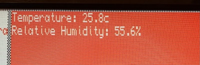

The test code
And the output

The test code

And the output

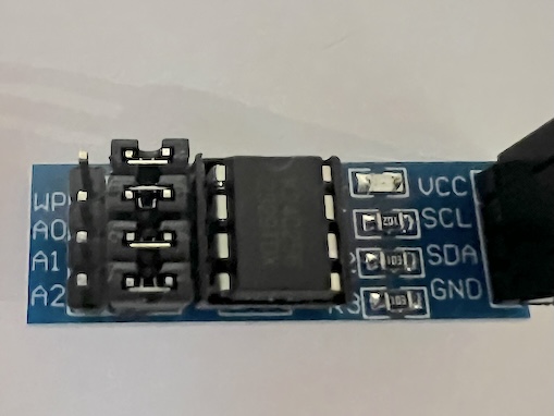

Next up is an AT24C256
This is a 32KB Non-volatile Memory Module
WARNING: The default ID is &A0 which is the SAME device ID as the Minerva Mk2 RTC/NVRAM so MUST be changed
For the purposes of the test programs I enabled jumper A2 which changes the address to &A8
The device (with ID still set to &A0 (&50 for I2C_IO) which caused all sorts of QL/Minerva problems until changed) In theory you can have 8 of these devices on the same i2c bus, but because of Minerva's ID you can only have 7

I recall reading that the Minerva MKII can only act as Master and that ID clash will therefore be with the RTC/NV-RAM device that is fitted alongside the EEPROM and PAL.
Not sure whether the RTC IC can be configured for another ID, but would imagine so...
