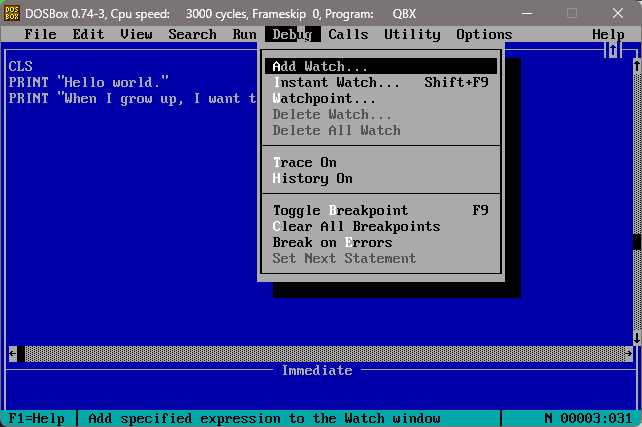

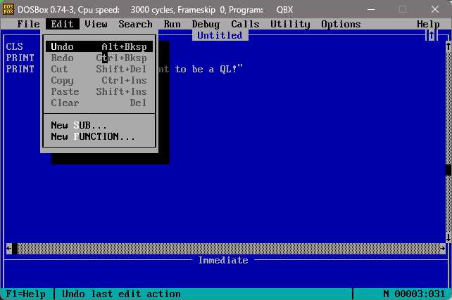

I can dream that one day someone far cleverer than me will write a proper development environment for QL BASIC. I've been using the IDE in Basics like QBasic on the PC and although it's old-fashioned and clunky, it works quite well, allowing you to do things like copying and pasting bits of code, search/replace and debugging such as setting breakpoints.
Edit menu in QBX
Edit menu in QBX
Debug menu in QBX
Debug menu in QBX
