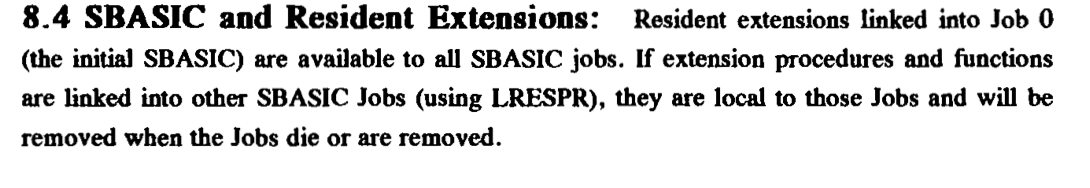

RalfR wrote: Mon Aug 18, 2025 5:01 pm So an SBASIC daughter job is not the right way for testing. Never knew, that this happens. Any remarks for that in any documentation?
Early SMSQ/E manuals (the QXL manual, for example) were pretty clear about this
This was just some random manual I had lying around. I'm sure that later manuals also point this out clearly.
Posts: 1259
Re: QPC2 MultiBASIC: Load SBASIC machine code function resident
Yes, but "NEW" removing all in a daughter job is not stated!
