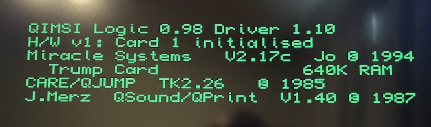

Not expecting to find a solution to this, would just like to understand, as much as possible, if this is purely down to an address clash please?
If I configure QL(JS)->512KB->Trump3->QSound/Qprint the Qsound is detected and commands like explode/bell/shoot work fine from QDOS along with Floppies. Haven't tested functionality any deeper than this
If I configure QL(JS)->512KB->Trump3->256KB->QSound/Qprint then the QL halts at a white screen
If I swap the QL ROM to Minerva for this same configuration it halts with a RAM fault
Normally I've used QSound with QIMSI/Microdrive (as I don't have any other non-memory expansion cards with pass-thru) but would just like to understand what's going on please?
