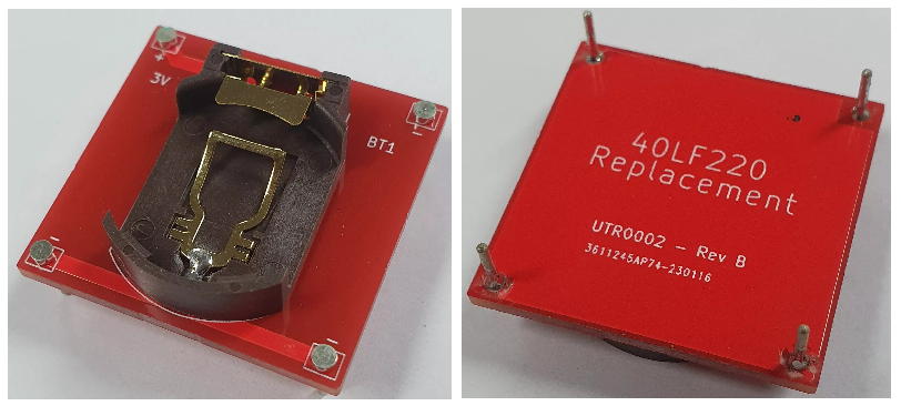

i am trying to repair a goldcard , but ..................
i noticed the backup battery is 0 volt .
has anyone ever made a adapter pcb to accomodate a regular cr battery ?

AFAIK only Tetroid do an adaptor for use a standar lithium 3V battery.

In the past I've dremelled out the resin/epoxy and put in a new battery under the red square lid. It's tricky and you have to be very careful, but can be done.
Posts: 1024
Re: SAFT 40LF220R Memoguard Lithium Battery 3V
An Australian seller on eBay does an adapter board
My SGC came with one, not fitted, but I had to replace the 4 legs with thinner wire (I cut the wire off a large capacitor)

The AU eBay board is the first thing that comes up when you google the SAFT 40F220R. That looks like a pretty simple PCB project for someone good at designing them.
[Edit: that's a weird design. It T's off in the front for 2 of the 3 negative contacts but then uses the entire back to connect all 3 of them. Why not use less copper and connect all 3 on the top with an extra trace?]

It may even be possible to do it on a bit of Vero board?

anyone with Gerber's to make this adapter ??

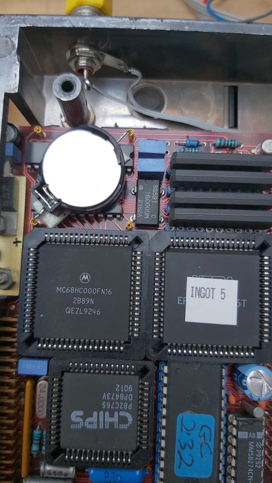

Post by Maskenlos »
This is, how I solved the problem:
Stephan
