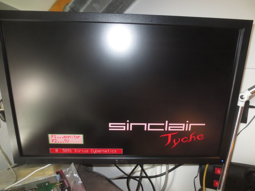

i would like to make one functionable tyche , only for collecting purposes .
Anyone got info on an eprom adapter to do so ??
techy
Posts: 384
Location: belgium
Re: SOLVED !! is it possible to install a tyche rom in a real ql ??
Post by techy »

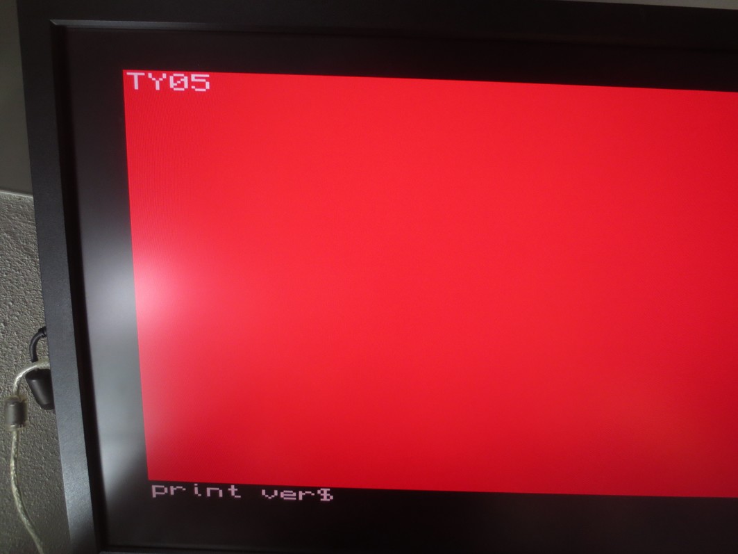

And it woks !!
now to find a sensible use for it ;-)

anyone got info about tyche TY07 ??
