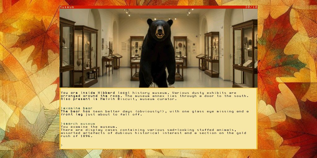

I've now finished my attempt at writing a new adventure game, and have done 2 versions, one for QDOS and one for SMSQ/E, written using Q-emulator. I've done over 60 colour screens in _pic format, in Mode 33. Now I've finished, I thought I'd download QPC2 and see if it would run on that, and it does, but without the pics.
FPIC_LOAD gives error -19 (wrong mode). So mode 33 (QEM version) and mode 32 (QPC2 version) are incompatible. :cry:
I've tried poking the header bit for mode, and the pic then loads into QPC2 but looks so wrong. Am I going to have to redo all my pics in Mode 32 and make a 3rd version???
I could make the first 2 versions available for download if there is any interest. I mainly did it as a challenge to myself, but it would be great if others could play it too.

Try out Finding Evan - a text adventure with graphics for SMSQ/E & QDOS
[Another adventure coming soon: Otis Travels In Space - PM me if you want to try the beta, QDOS only]
