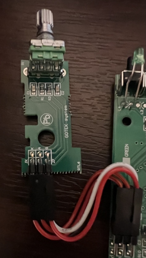

I've extracted the rotary controller from the GoTek and I can't for the life of me find anything similar on eBay/Amazon
Also, all the rotary controllers I can find, even if they say they are for gotek, only have 4 cables and this one has 6??? (2 black cables don't show up well in the picture)
Anyone have any ideas please?

The raw encoders have 5 contacts - common and a and b for the encoder - and 2 pins for the switch - clearly common and one switch pin can be wired together - so this gives 4.
I suspect not all of the 6 wires need to be connected. However - your encoder board does have rc filtering on the a/b encoder outputs

Pr0f wrote: Sat Mar 08, 2025 12:30 pm However - your encoder board does have rc filtering on the a/b encoder outputs
Rc filtering?
Thanks
Posts: 1628
Re: GoTek Oddity
Yes - I think the resistor is in series - and the capacitor goes from ground to encoder output - small value.
https://www.allaboutcircuits.com/projec ... d-project/
