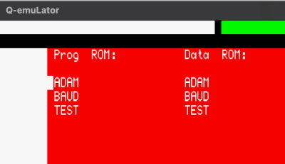

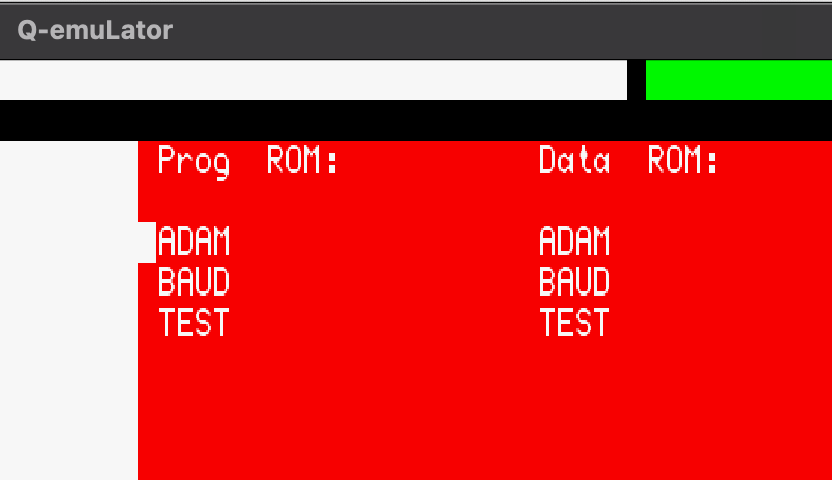

I've been trying to find a way to put some of the 68K/OS tools into "ROM DISK" to
a) Make them available to Q-emuLator
b) Burn the most important utilities into real EPROM to plug-in to the 68K/OS hardware

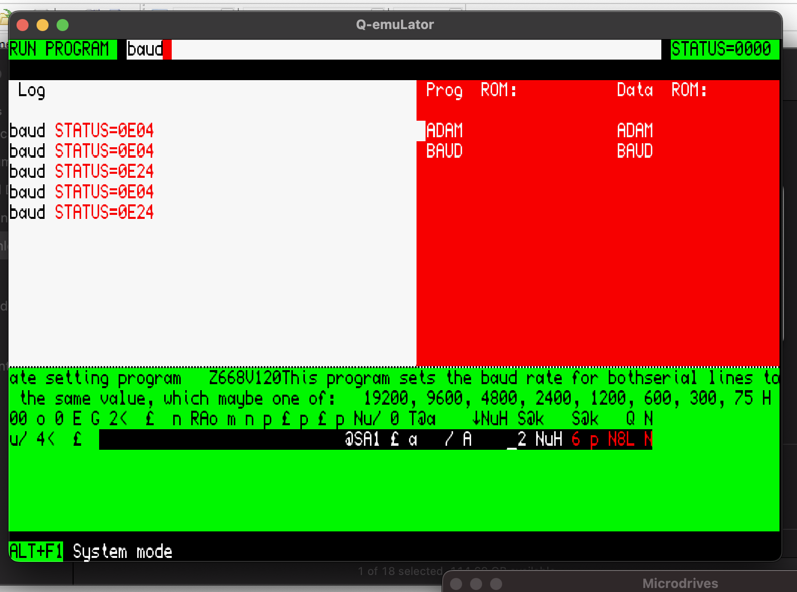

So far I have a ROM image for Q-emuLator that lists 1 program (BAUD) under the "ROM:" device
Am still trying to find out how to have multiple programs listed, but can run BAUD (sort of!)
I'm pretty sure now that the existing dumps (at least of BAUD & a couple of others I tried) of the OS disk programs we have in the downloads section are corrupt (am going to try and make a dump on the hardware to manually compare BAUD byte by byte as it's small, or I may try to make new serial dumps). The reason I assume this is because of the results you can see in the image below
EDIT: Although, thinking about it, it may not be a corruption but something to do with the offsets in memory. Needs further investigation

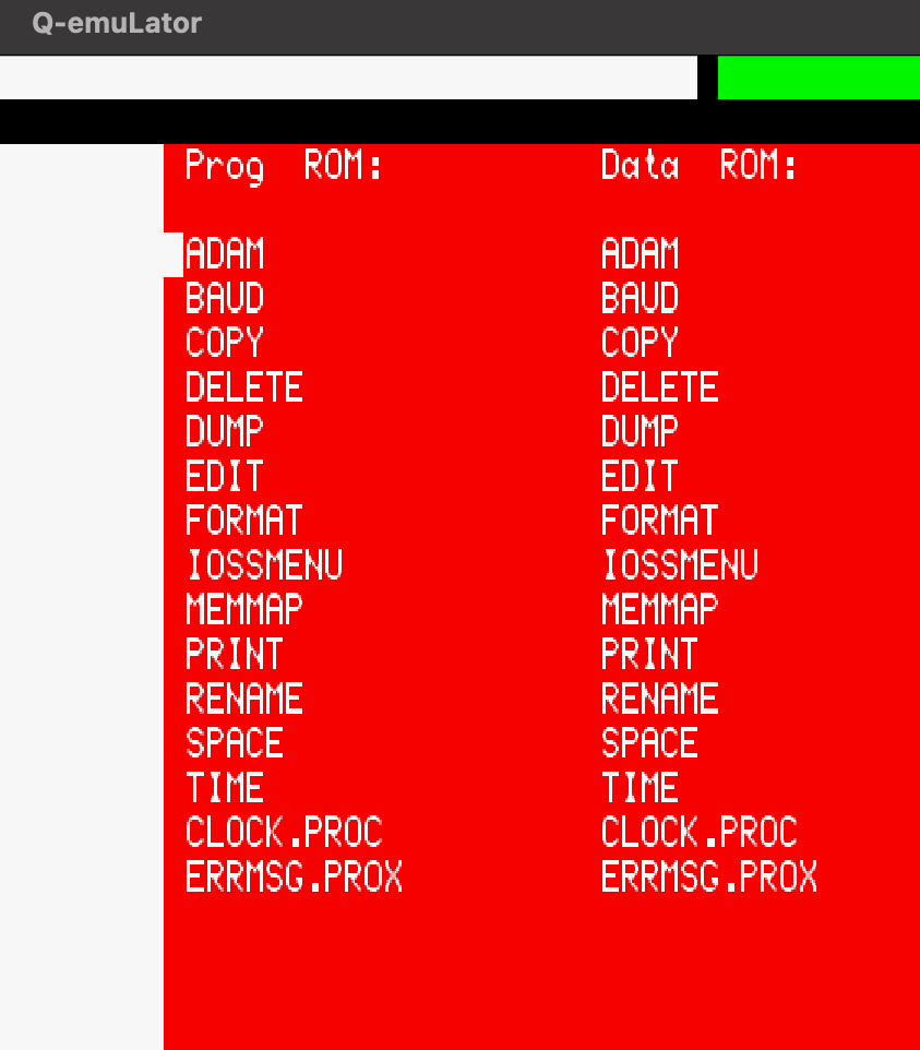

Oh yes! Well chuffed... (persistence pays off and it was so simple in the end)
Re: 68K/OS "ROM" based disk attempt

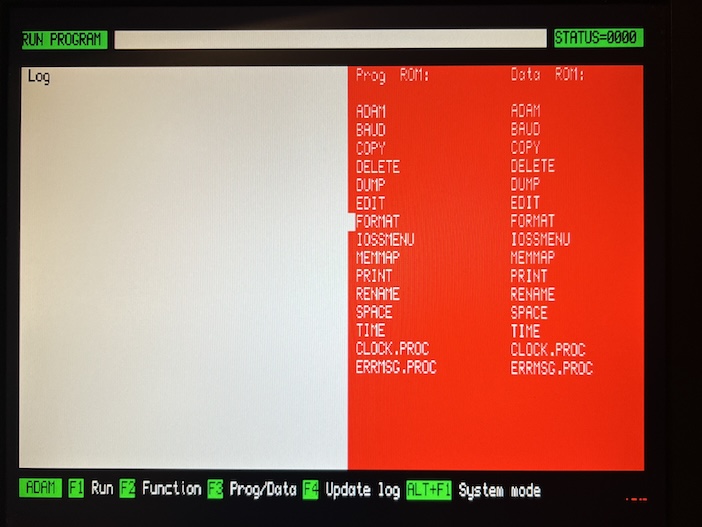

Have left out the 4 least important applications due to space constraint, and errmsg.proc is renamed as it's where 68K/OS loads error descriptions from and again I think it's a corrupt file
I guess the next job is try some new file transfers over serial (starting with errmsg.proc) to try and run something properly

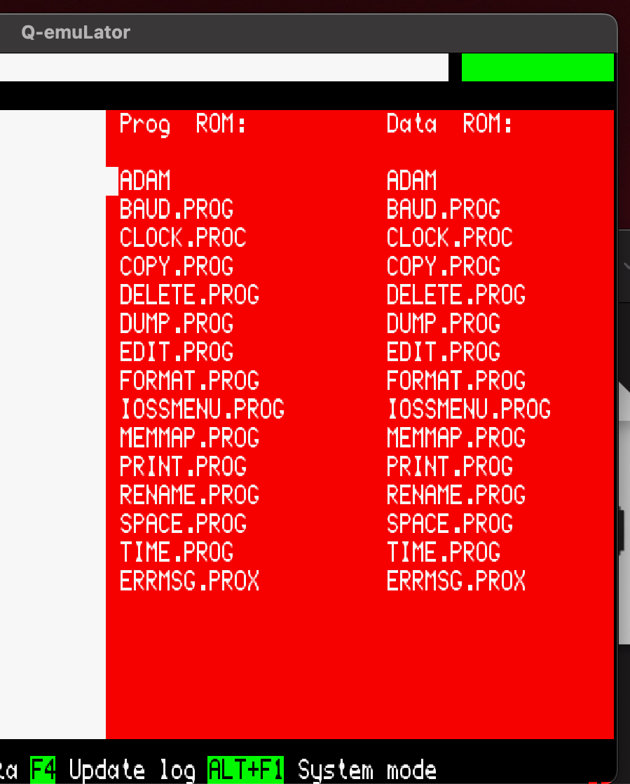

Was fed up of typing ".prog" so have used programs internal names. Looks tidier too
