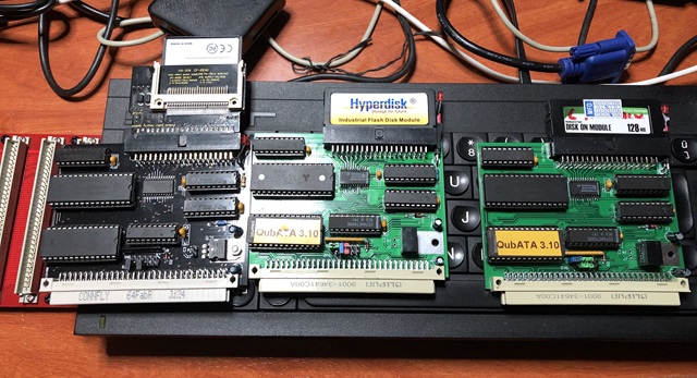

Lately I'm doing some tests with my Leandro's clones of the QubIDE and I found something strange loading the QubATA 3.10 driver from from the REXT file. Meanwhile the old Qubesoft Rebel driver loads from floppy and detects the QubIDE with no EPROM in place, the QubATA REXT can't see tge QubIDE if there is no EPROM with driver. So to test a new interface I have to use the Rebel REXT if I don't want to burn a new EPROM at this stage. Is this the normal behaviour of the QubATA driver? BTW I can't find older releases of the driver to test (3.06 or 3.08). Does anyone have a copy that can be downloaded?

Tested with this release 3.06 and I got the same behaviour. With no EPROM fitted the QubATA driver can't find the GALs. I used the config utility to change the base address and this release can't be modified to use QUB partition scheme. I had the crazy idea of boot from one QubIDE and then load the driver using the QUB name to initialize a second one and be able to copy files from one to the other....

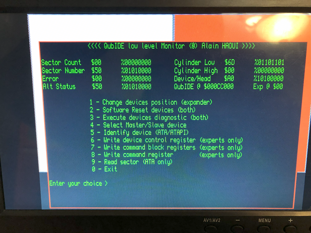

I downloaded the MonQubIDE utility programmed by Alain Haoui from the dilwyn site: https://dilwyn.theqlforum.com/qlrom/inde ... ubide.This utility i a SuperBasic program that can tell you the base address (and a lot more info) after booting with the QubATA rom in place:
