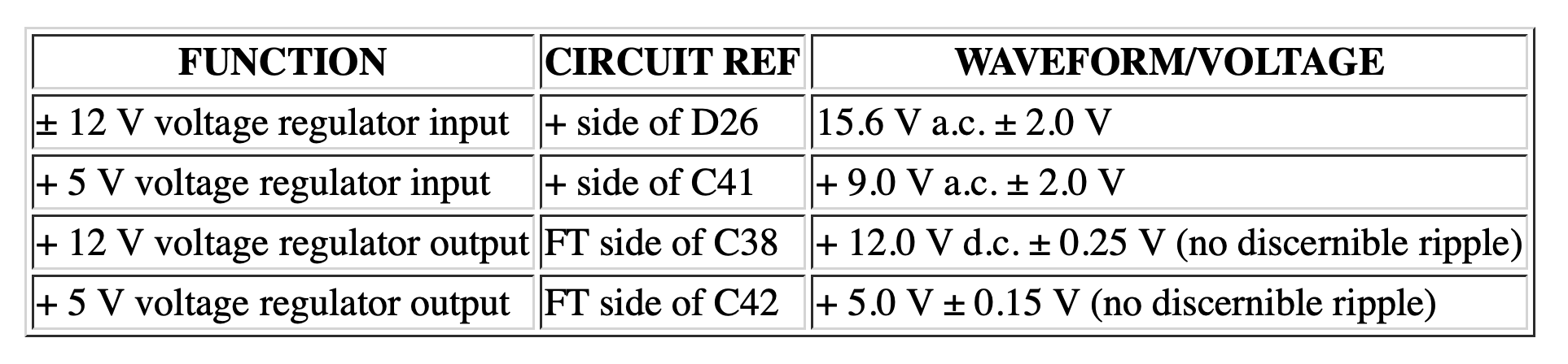

t0nyt wrote: Thu Feb 15, 2024 8:56 am Could I ask where I should check the voltages inside the QL please?
Would like to double-check the spare PSU and I also have an issue with a vRetro PSU I’d rather be using so need to check that too
No real need to. There is a set of very reliable voltage regulators in the QL that either spit out the correct voltages or none at all. What you should observe a bit with an unknown PSU is excessive heat. The rather outdated regulation circuits in the QL basically transform whatever comes into the QL that is too much for its circuitry into heat and dissipate it into the air.
If you absolutly want to, the following table from he service manual shows where to measure and what the acceptable limits are.
Posts: 1004
Re: QL PSU Voltages
Thanks Tofro, but I don’t know much about this kind of stuff
I assume I put the red probe as per the chart, but do I use a single ground point for the black probe please?
Posts: 1586
Re: QL PSU Voltages
Yes - if using a multimeter - put the black lead on ground - a good place that's convenient is the modulator housing, and then use the red probe to take your readings - but if the voltage you are measuring is AC - then you will need to switch the multimeter to AC range for that reading. You will get erroneous readings if you leave it in AC mode to measure the DC voltages.

Posts: 3158
Re: QL PSU Voltages
t0nyt wrote: Thu Feb 15, 2024 9:47 am Thanks Tofro, but I don’t know much about this kind of stuff
Because you need to ask: Don't accidentally connect pins when you set the probes, they need to go where indicated and exactly there, or you may fry important components. If you feel unsure, refer to the first sentence of my answer, and if the QL seems to work, there's actually no need to fiddle with it, there's nothing to gain from it.
