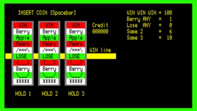

qbits
Posts: 252
Re: Start of a Game
Post by qbits »
Hi NL_QL_Usr
I like your ONE ARM Bandit. You suggest you’re back on a learning curve with SuperBASIC so hope you don’t mind I have made a few changes to your code. Attached is a jpeg as how it appears with my QPC2 Emulator which extends the colours in mode 4.
Further suggestions you could use different Font sets and the CHR$(n) command to display aliens sprites, coins instead or you present print lines rol$(1) =” WIN “ change to = CHR$(n)&CHR$(n)&CHR$(n) etc.
QBITS
ONEARMPlus_bas.zip
(2.19 KiB) Downloaded 138 times
NL_QL_Usr
Posts: 95
Location: Harz DE
Re: Start of a Game
Post by NL_QL_Usr »
Hey Qbits;
That looks better already. I like the bigger Block for the winline.
