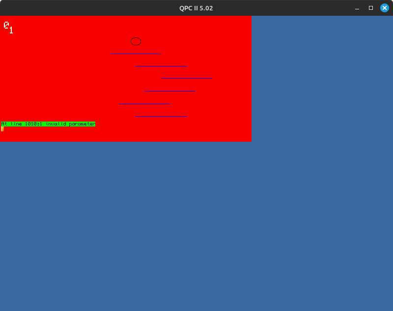

- Posts: 4796
Re: turtle position
Hi Steve,
Penny_Drop3_bas stopped with an Invalid Parameter at Line 1010
Re: turtle position
Derek,
that's likely when you have Turbo Toolkit loaded. It masks the SBASIC PEEK_F with an own implementation that lacks some features to the original. Was mentioned by Dilwyn some posts above.

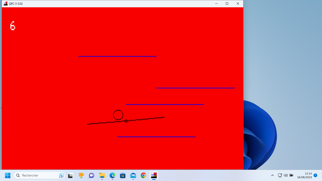

- Aurora
- Posts: 898
Re: turtle position
Hi Derek,
Just reloaded the Penny_drop3_bas from the forum and it ran ok under QPCv5.02.... (See Screen_shot).
Dilwyn warns that if you have Turbo TK loaded, it has its own PEEK_F which can cause problems ?
By the way, my QPC2 is configured at 512x256, but I doubt if that may be the cause....
Sorry if this is not helpfull !
Steve.
