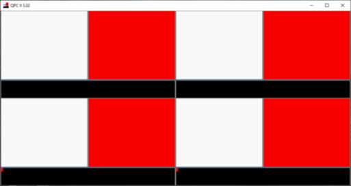

I remembered another option when I woke up at 3am this morning. When using SBASIC if you don't want to adjust the sizes of the windows (just locations) another option is to use the WMON and WTV commands with the additional origin parameters. Until fairly recently, I had a set of altkeys set up to reposition the windows in the 4 corners of my QPC2 window. Retyped from memory, so might need a correction:
ALTKEY '1','WMON ,0,0' & CHR$(10) : REM top left
ALTKEY '2','WMON ,SCR_XLIM-512,0' & CHR$(10) : REM top right
ALTKEY '3','WMON ,0,SCR_YLIM-256' & CHR$(10) : REM bottom left
ALTKEY '4','WMON ,SCR_XLIM-512,SCR_YLIM-256' & CHR$(10) : REM bottom right
Note that there is a single space between WMON and the first comma - no 'mode' parameter, just a blank one, so it should work in all modes without trying to change modes.
Pressing ALT 1 resets the window of the current SBASIC job to top left. ALT 2 to top right. ALT 3 to bottom left. ALT 4 to bottom right.
Should be possible to adapt to hotkeys or DO files I guess (not tried), or possibly adapt to use your x_% and y_% variables. I know that the WMON (and presumably WTV) work for the SBASIC window the altkey was pressed in, not just job 0.
Also, by happy coincidence, WMON and WTV in SBASIC seem to manage their own outlines so the BASIC windows can be moved outside their original top left position without needing OUTLN commands.
Can't remember why I stopped using these, maybe I'm not using as many SBASICs as I used to.
When you end up with a screen layout like this in 1024x512 display in QPC2, it gets confusing after a while when you happen to have 3 SBASIC jobs along with the original Job 0 SBASIC!
WMON on ALTKEY with SBASICs
