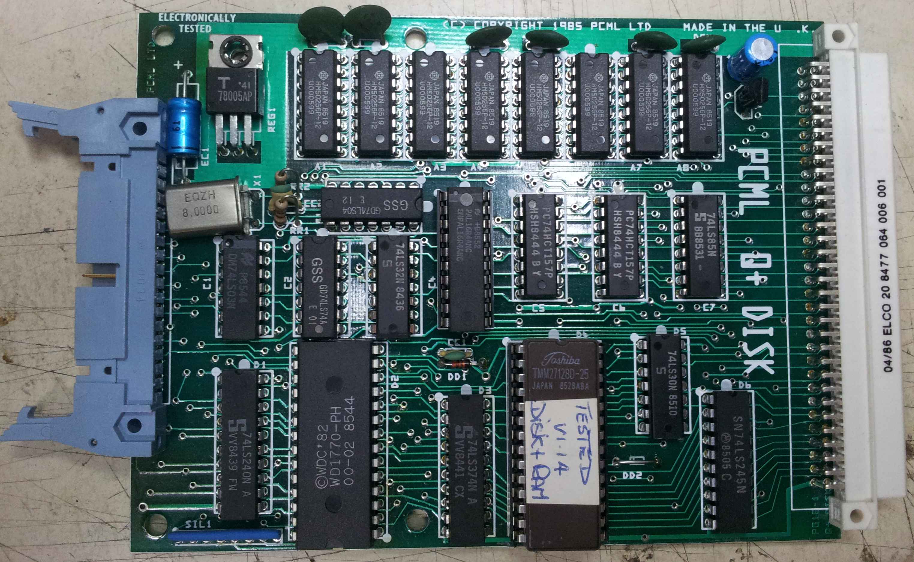

- Trump Card
- Posts: 162
Re: PCML Q+ Disk Interface RAM
(not my interface, just happened to have picture)

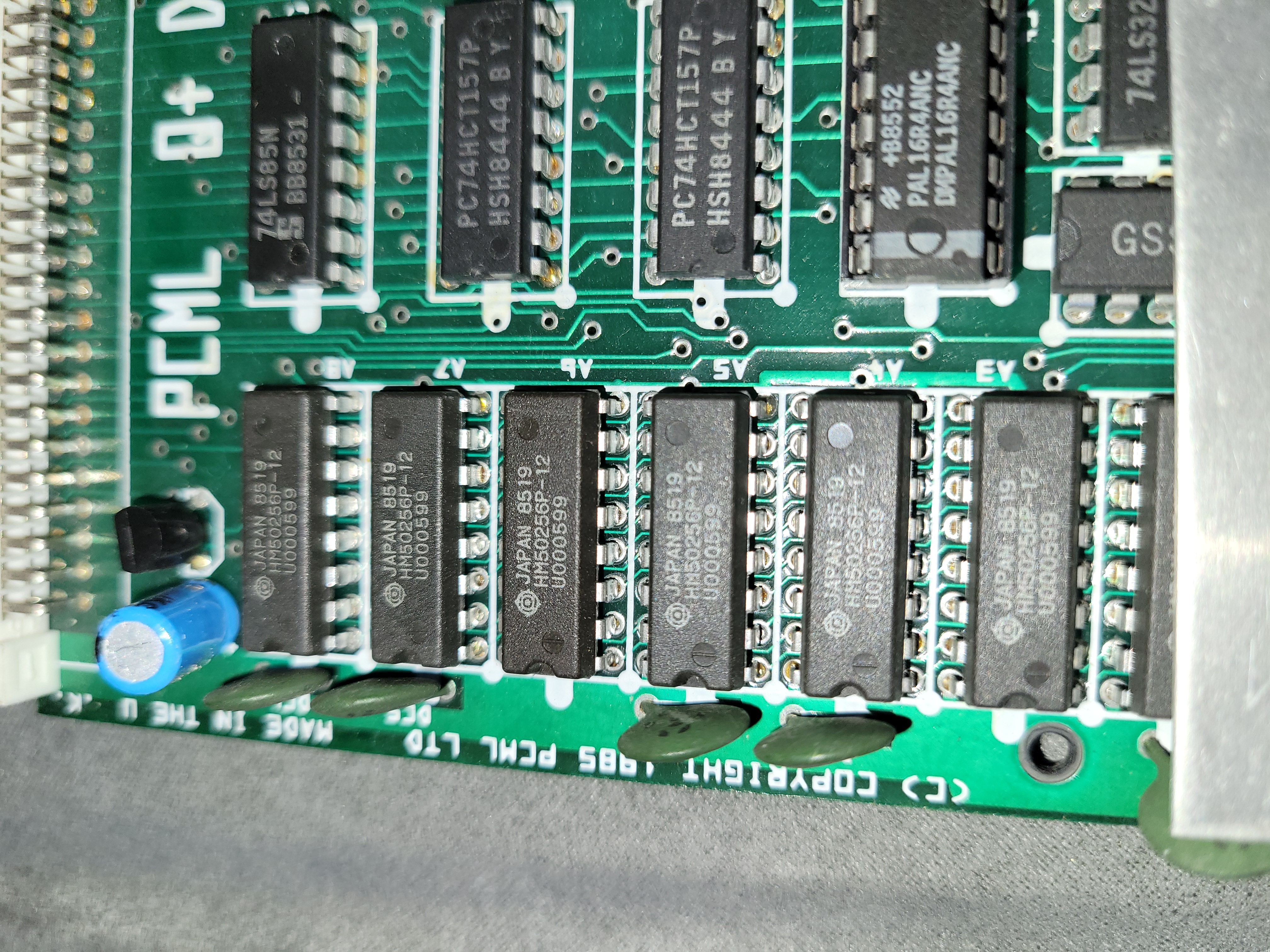

Hi folks,
I have a PCML disk if. The chips used - see pic.
Regards Klaus
Regards Klaus

Hi Derek,
Sorry, I am not able to read the gal. I don’t have an adapter to my Willem programmer. I am looking for one. If I can find a schematic, I will try to build one.
Regards
Klaus
Regards
Klaus
