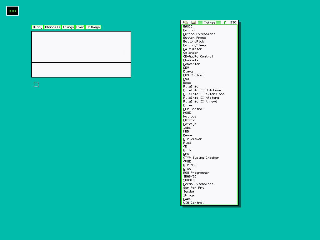

I thought I would see how many things are created by one of my QPC/SMSQE setups. The answer is 47. I know what 36 of them do but not the rest, and I have no idea how to create one. I do not want to use EasyPtr, but do want to learn more about Things. I would like to read George Gwilt's articles. Are you able to list them?tofro wrote:- George Gwilt (anyone heard of him, recently, BTW?) has written a set of excellent articles in QL Today on Thing usage and creation.

As Derek remarks: Things do not seem to be a thing of interest on this forum and in the absence of a reply to my post I have spent a few hours collating all that I could find on the subject. The results might prove to be useful. I have scanned through the documents and have succeeded in creating an executable Thing written in SBASIC. I have also managed to create an executable Thing the creates another executable Thing.
My answer to Derek's original question - " If a Thing creates a new Thing, does that new Thing belong to the Thing that created it? " is , in the case of executable Things, no. I see no evidence of ownership on my setup.
