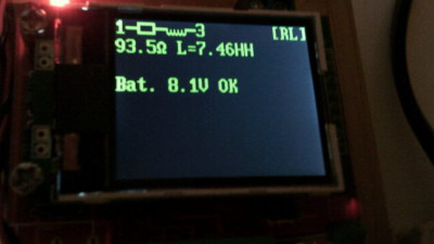

ones' complement
Posts: 162
Re: QL Power Supply Primary Winding
Post by ones' complement »
Ruptor
Posts: 420
Location: London
Post by Ruptor »
ones' complement wrote: Sat Dec 03, 2022 4:54 pmSame as mine, about 67ohm.
Why does your inductance meter say 93.5R? Just curious why DC resistance would be different between meters. :?
ones' complement
Posts: 162
Ruptor wrote: Mon Dec 05, 2022 9:17 pm
The meter would be applying a constant DC voltage. The component tester (using ATmega328) would, I assume, be repeatedly applying a slow varying (or step) voltage to judge inductance, so the extra resistance value is from reactance. At 50Hz the reactance would add considerably to the effective resistance.
Ruptor
Posts: 420
Location: London
Post by Ruptor »
ones' complement wrote: Mon Dec 05, 2022 10:22 pmThe meter would be applying a constant DC voltage. The component tester (using ATmega328) would, I assume, be repeatedly applying a slow varying (or step) voltage to judge inductance, so the extra resistance value is from reactance. At 50Hz the reactance would add considerably to the effective resistance.
My inductance meter returns the identical resistance to a multimeter on a simple inductor but when I tried to measure the QL transformer inductance across the mains plug live & neutral it thinks it is a transistor. :? Perhaps the QL transformer has some protection or filter screwing things up.
