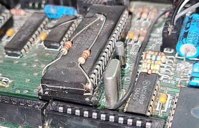

And can you confirm if ZX8302 has pin 21 into the socket or bended away as I found in mine?

In the picture is showing your 8302, there is a pin that is bent and possibly giving an intermittent connection.
The bent pin 21 is not standard on all QLs, only all example of someone not fitting the chip correctly.
You need to remove the 8302 and straighten the bent 21 pin, clean the pin legs and replace into the socket.
The 2 resistors are factory fitted to improve a microdrive reliability, will be required to be connected.this should solve you problem.
I saw your post on Facebook, but was surprised that no one suggested straightening the bent pin.

I can confirm the advice below - Pins 19 & 21 of the ZX8320 are the RAW2 & RAW1 (respectively) data-lines connecting the 8302 to the MDV ULA(s) of the drive units themselves.
They must both connect cleanly with the socket.
The flying resistors soldered directly to these pins, and joined to the (relatively clean) -12V power-rail exposed at the RS232-level converter IC25, are there to provide the necessary 'pull-down' for the 2 data-lines of the MDV circuitry, which appear to be of the 'emitter-follower' type - i.e. the ULAs drive the lines High/active, but rely on external pull-downs to take the signal back to ground (or here, -12V, via the flying resistor modification.)
The soldering of that resistor mod on your unit may be interfering with the pin engaging with the socket, so the last time it was inserted, may well have bent the pin out rather than seating correctly...
Side note for anyone interested - On the ZX Interface-1, Sinclair used 2x 10k pull-down resistors to Gnd, rather than what we see on the QL. I have often specuiated as to why this mod was devised for the QL (which I typically re-arrange by re-soldering underneath the board, to allow ease of replacement of the 8302), rather than the simpler approach used on the Interface-1. Given what we now know about the relatively poor noise-floor of the QL power-supply Gnd line, I suspect that using a fairly clean power-line like the -12V rail instead - and using correspondingly higher value pull-down resistors - was a means to reduce the noise on the RAW1/2 lines. Removal of the pull-down resistors can still work (I have one QL without a -12V rail and just ditched the resistor mod altogether), but leaves you dependent on the inherent capacitance of the MDV bus to form an acceptably clean 'falling-edge' of the RAWx data-lines. Not recommended...

First thing I've done was refitting the IC into the socket properly. And nothing changed. Microdrives still doesn't work and oqtadrive worked for a short period but now all I get is the "not found".
So I need to test the board part some how. Specifically the ZX8302 in case I have to buy a replacement..

Just a thought that if the pull down resistors were not in circuit because the pins were not in the socket & resistors R107 & R108 of 33K that are shown on the circuit are not fitted then the inputs of IC 29 & IC30 would be floating. Perhaps this could have blown up the inputs if they are open circuit and once blown would affect anything else connected to the RAW lines. If the Oqtadrive uses the lines then disconnecting the internal microdrives might allow it to work. I wrote this quick does it make sense?bola_dor wrote:First thing I've done was refitting the IC into the socket properly. And nothing changed. Microdrives still doesn't work and oqtadrive worked for a short period but now all I get is the "not found".

1. The schematic for the Iss 6 is perfectly valid for the Iss 7 boards, in so far as the MDV circuitry is concerned - as far as I can tell, the Iss 7 has a slight rearrangement of the components plus some previously documented Iss 6 mods being applied at the factory. Whilst there may be some more subtle changes, I my experience, these won't impact what you are seeing here, so feel free to refer to the Iss 6 schematic.
2. You previously mentioned that, withe both internal drives fitted, the oqtadrive worked intermittently, but now does not. Likewise the external ZX MDV unit failed to allow format/reading when connected as MDV3_. My experience here pints to one or both of the internal units ULAs already on the verge of failure. If the ZX unit as MDV3 continues to spin , it can be because the ULA of one of the internal units is messing with the Comms Clk or Comms Select lines when they (should be left alone when the internal drives are de-delelected) that are fed out and into the next unit in the chain (more accurately, Comms Clk is common across all connected units, and Comms Select-Out on one unit feeds the Comms Select-In on the next drive in the chain.) Alternatively, if either or both of the ULAs of the internal units chooses to remain active when it shouldn't (because MDV3 is being selected), then the RAW data-lines may also being left active and interfering with the ZX or oqtadrive's ability to drive the data-lines, which can confuse QDOS which leaves MDV3 active rather than detecting the error and deselecting the drive as you would notmally expect .
3. Now that you have re-seated Pin 21 of the ZX8302, can you confirm whether the oqtadrive is now connected on its own as MDV unit 1 and, if so, does it still show intermittent behaviour?
4. My experience suggests that, whilst the MDV ULAs can and do fail, they are sufficiently 'robust' that the 'floating' RAW dataline shouldn't have permanently hurt them - more likely that one or both of the internal MDV unit ULAs are already kaput.
