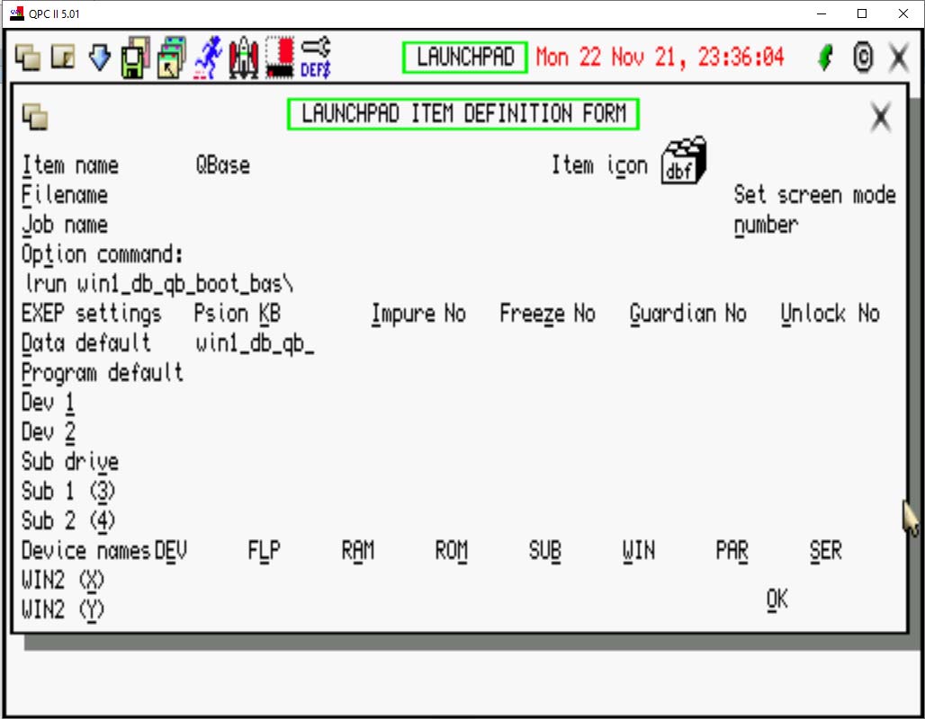

By leaving the filename box empty in the Item Definition Form, you can set up a "type in" command for SuperBASIC or SBASIC (or any named job). Enter the command into the Option Command box. To send the command to BASIC, leave the Job Name box empty.
If I configure the filename of an executable then it works (it launches it at DO)
But if I leave FIlename empty and I configure the Command then BASIC is started, but the command is not passed to Basic and is not executed.
How can I use the Command property in order to lrun a basic program or to start aprograms with parameters?

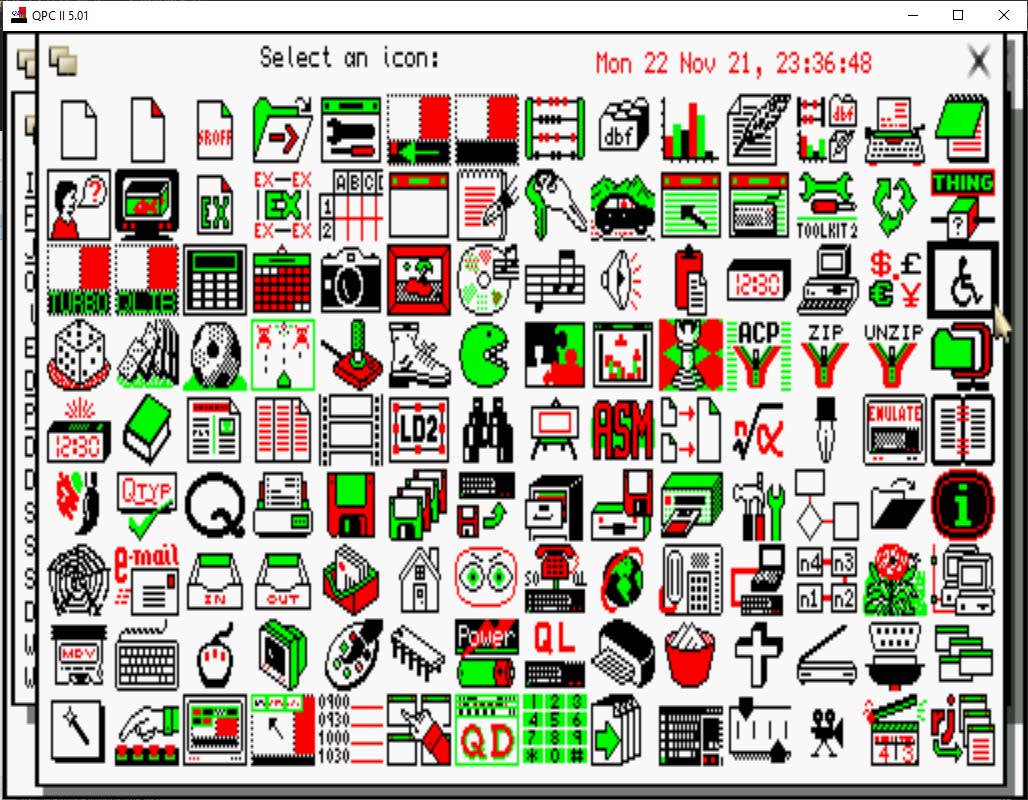

When you click on the Item Icon box in the form, a further screen comes up listing half of the available icons (to show the other half of the list click on the Page button at the top of the screen).
Which one is the Page button? I cannot find it!! (LATER EDIT: Found it! It was hidden under the clock!)
Is there a way to add icons to that list? or to change the icon with a different icon, one that is not shown on the icons page?

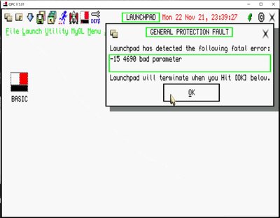

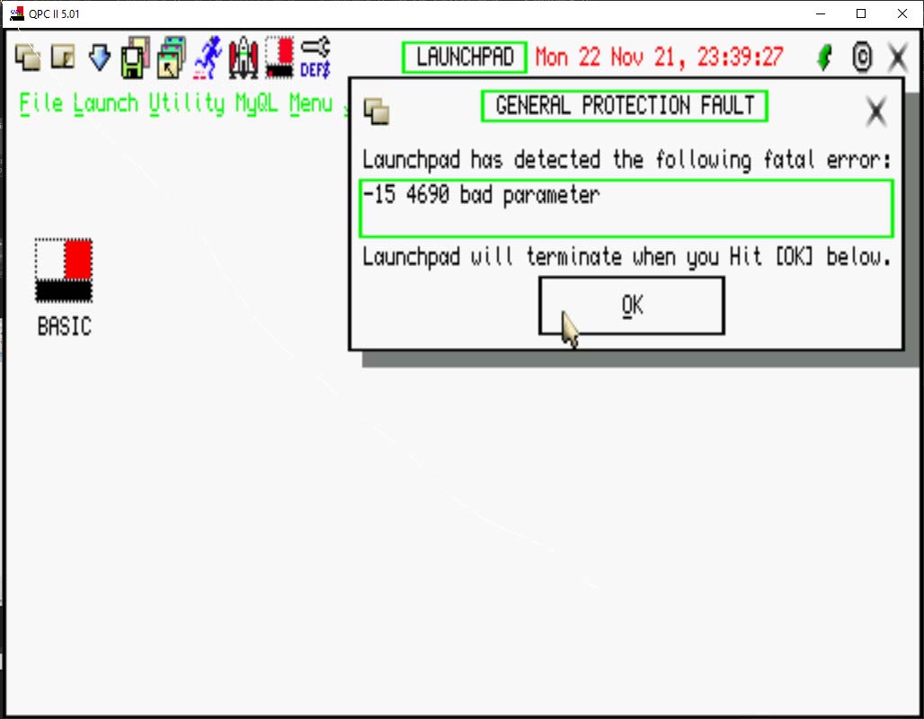

Do (right click) on the original icon, select the COPY command from the menu which appears and then move the icon to the location where you'd like the copy to be placed. If you want the copy to go on a different desktop menu, move the icon to one of the four menu selection commands at the top right and click on the one required, which will display that particular desktop. Move the icon over the location where the new copy of the icon is to be placed and Hit or Do on that location. The definition is copied there.
Well, when you Hit or Do on that location you get the following error.
Is this a bug or am I doing somethin wrong?

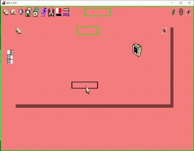

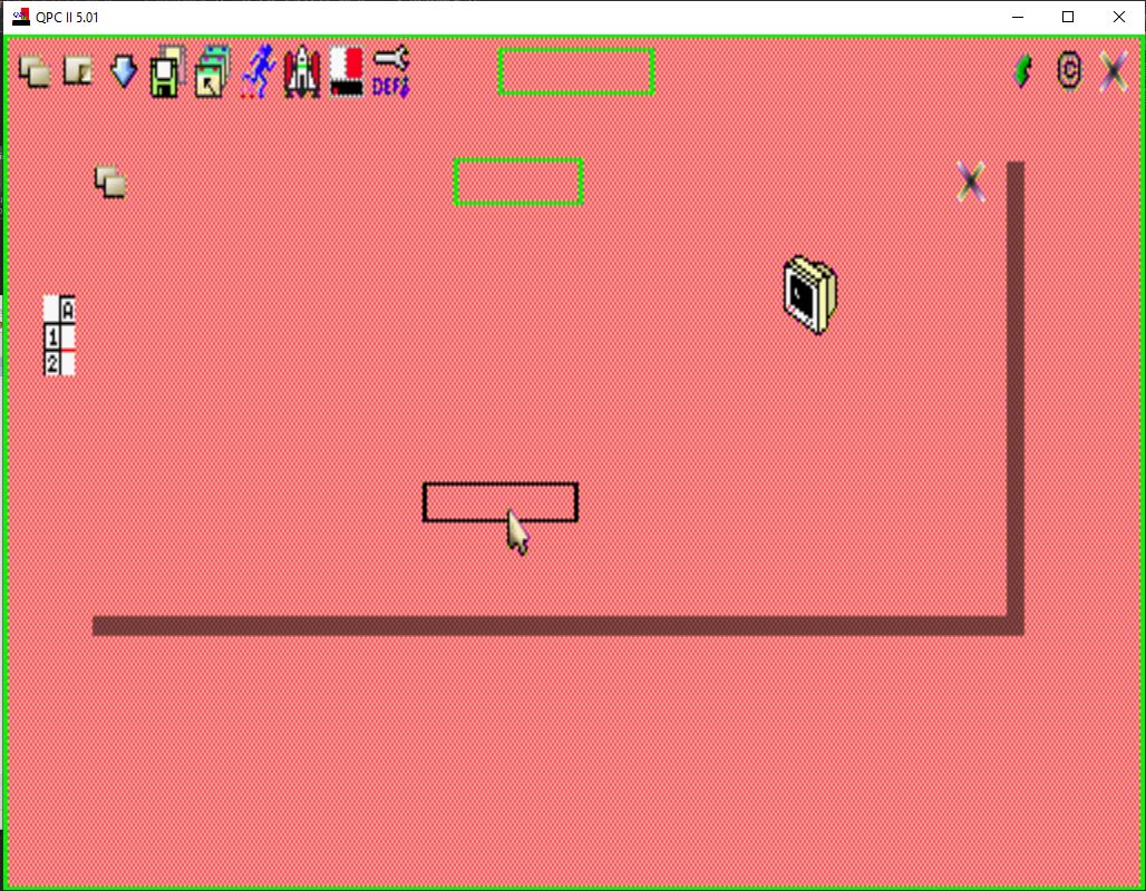

Running on QPC v5.01 SMSQE 3.38 8,16 or 32 bit colors, when I change the theme the new colors are not applyed. The only result is this:
Is there a different way to change the theme/ colors?

2. Yes, Page button hidden under the clock. I never liked the clock, someone asked me to add it in the very early days, hides the icon in some display sizes as you found. Best thing is just turn the damned clock thing off. You can't change the two pages of mode 4 icons, they are appended to the Easyptr file linked to the compiled program. If using v2.02 or later of Launchpad, the method of adding extra icons is listed in the HISTORY_doc/txt file in the description for v2.02. The manual never did updated for this <oops> . Basically, the list of sprites for the extra page is held in a plain text file called LP2SPRITES_dat. The first line contains the identifier characters "LP2S" (without the quotes), then subsequent lines contain a list of sprites to load. These can be mode 4 or 8-bit sprites. It was always a bit of a bodge but seem to work (never tried it with 16-bit or 24-bit sprites though)
3. This is a bug (and after a quick look at the code, it looks like something which may need a good bit of work to fix), something to do with the MAWITEM command in that line and only happens when the icon is moved to a different page. It's probably trying to put the icon in the page switch loose item by mistake, which is of course doomed to fail as it's not an application window menu item. What it should do is switch to a new page, then let you choose where to drop the moved icon. I have never seen this before, will look into it when I feel better. Because of timing issues, even if it works when dropped on the same page, you may find QPC2 is so fast that it actually goes on to execute the icon before you get a chance to release the mouse button!

dilwyn wrote:the method of adding extra icons is listed in the HISTORY_doc/txt file in the description for v2.02. The manual never did updated for this <oops> .
Of course, I hve not read the history file, only the manual :D Thank you!
dilwyn wrote:Themes. Can't reproduce this problem (I've only tried the theme files I supply). I'm assuming you're using the MyQL->Display->System Palette Theme to select a theme.
Yes - I am using MyQL->Display->System Palette Theme to select a theme. I tried manual refresh and also tried to restart Launchpad. Still doesn't work.
I have tried with both video modes 8 bit colour/ High Colour and both drivers Direct3D and DirectDraw - still no luck

Andrew wrote: 4. Change the theme
Are you sure the theme is meant for the mode 4 your Launchpad is running in?
The white/red stipple all over the place is 238, the default for any invalid colour.
You can check the palette with QCoCo from my site: https://home.hccnet.nl/b.spelten/ql/qcoco.html
This can show the numbers for all items, for a QL mode 4 palette anything above 255 is invalid.

BSJR wrote:Are you sure the theme is meant for the mode 4 your Launchpad is running in?
I am sure that theme does not work in mode 4, but you missed my line: Running on QPC v5.01 SMSQE 3.38 8,16 or 32 bit colors,
BSJR wrote:You can check the palette with QCoCo from my site: https://home.hccnet.nl/b.spelten/ql/qcoco.html
I was just looking at QCoCo ! Thank you!

I had a quick look at the handling of the System Palette files. It's possible that since there is no check on the number of entries in the theme file, that something might be going wrong here, I need to look at the code in more depth when I get a chance - it's a long time since I last updated the program.
Posts: 1050
Re: Launchpad
After I uninstalled and reinstalled QPC2, the themes started to work! So now everything works
