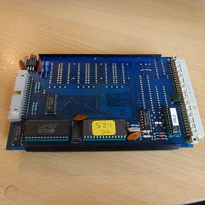

hello
has any one the jedec from the disk card??????
i think its different from trump 768.....
i itry 1v4_gal in a gal 16v8 200 and the ql has horizontal black and white lines

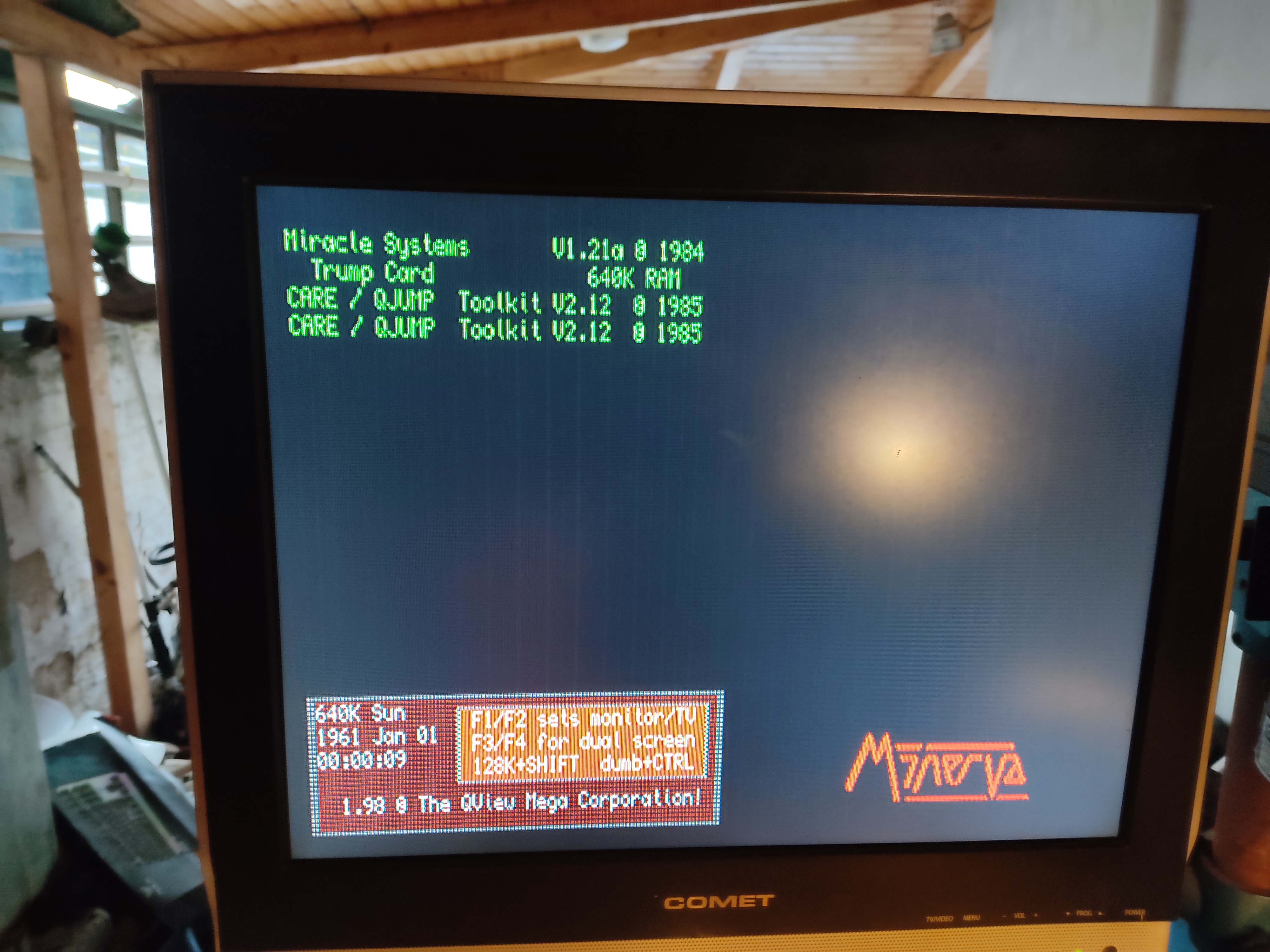

reassembled the file burn the jed on a gal 16v8 200 lnc
no i have boot but the ql stays on minerva logo show th640k of ram i have
(not in trump but internal)
and dint proceed on prompt....(i press f2 butt nothing)

with or without the f13??? on the others? baucose i made the trial without the f13 and i have blackwhite bars
Posts: 1587
Re: trump card disk card 0(zero) kb
you don't need the whole line that activates ROMCS that has /f13 in it - that includes the + (OR) at the start - just use only the first line
e,g,
/o19 = /i2 * /i1 * /i3 * /i4 * i5 * /i6
+ i2 * /i1 * i3 * /i4 * /i5 * /i6 * /f13 (this)
o19.oe = vcc
becomes
o19.oe = vcc
