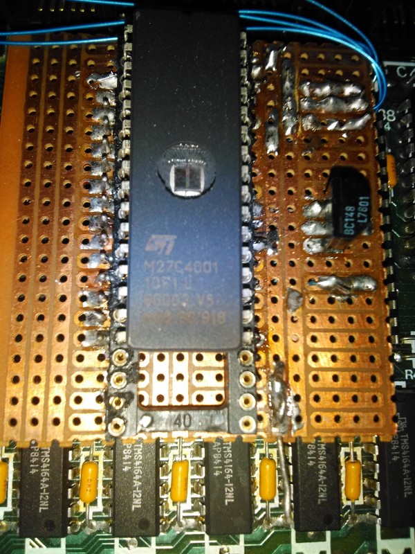

Posts: 420
Location: London
Re: EPROM codes
Post by Ruptor »
I use this one a M27C4001 to replace the QL ROMs and it currently holds three sets of QL roms that I can switch before turn on. The modern C type are much faster so any TTL compatible one should work and the bigger they are the cheaper they seem to be because nobody wants EPROMs they are all using Flash ROMs now. Just tie the address lines you don't need on an EPROM that is bigger.
