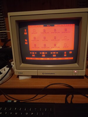

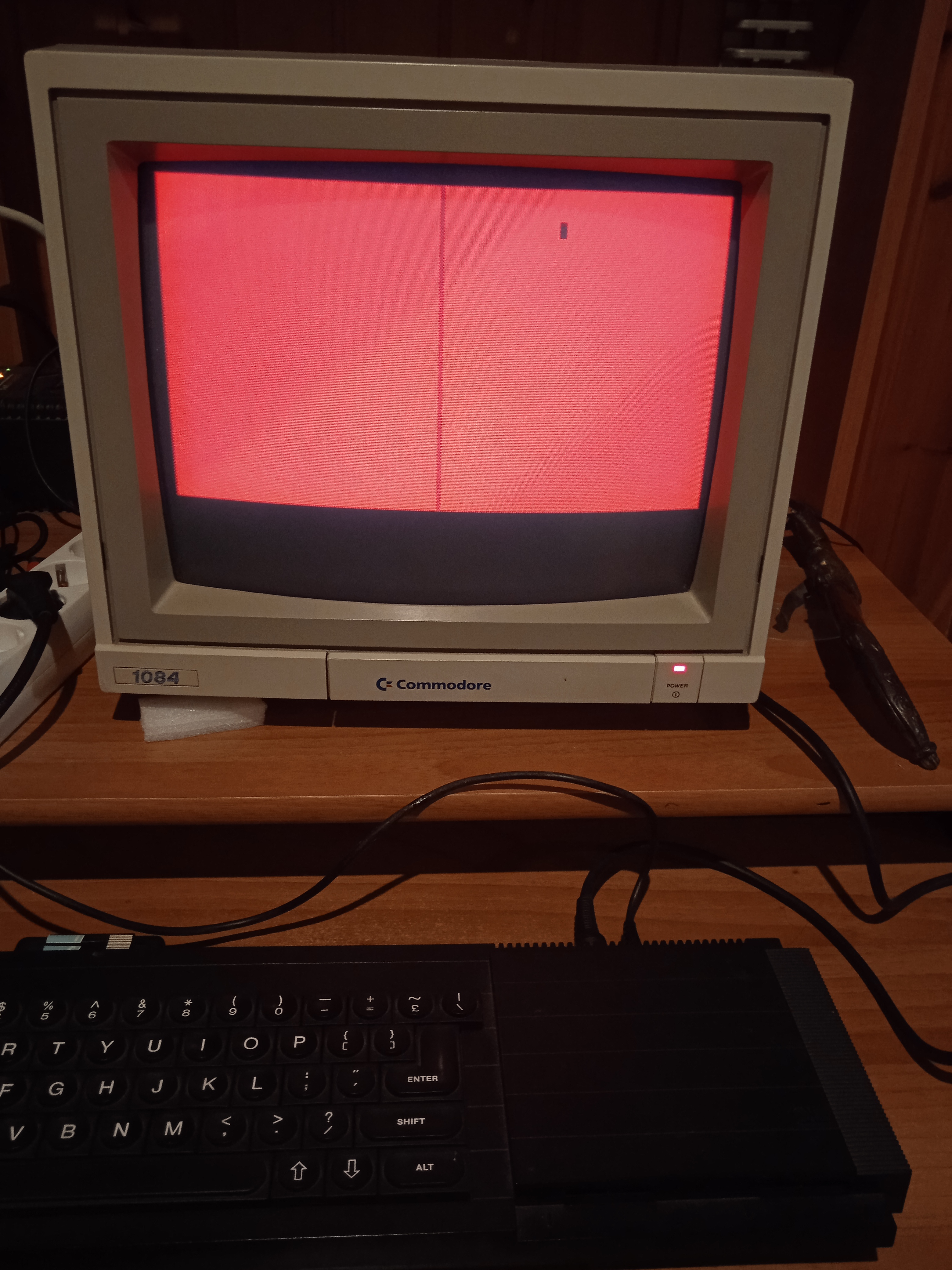

Only red!!
mhanias
Brittle Membrane
Posts: 113
Only red!!
Post by mhanias »
Is it a ZX8301 problem? The scart cable works fine with other QL
Michael
TitoxUnix
Posts: 29
Joined: Mon Jan 18, 2021 7:41 pm
Re: Only red!!
Post by TitoxUnix »
Connector pin desoldered from the motherboard by the efforts?
Something similar I got with a Philips MSX last year.
Posts: 1590
Re: Only red!!
one thing you can check - if you have the UHF lead (phono to tv ariel) you can connect up a telly with that and see if all your colours are there - if so I would suspect the connector on the motherboard
Posts: 3172
Re: Only red!!
Does colour over the RF output work? If yes, it's most likely a loose connector on the motherboard.
mhanias
Brittle Membrane
Posts: 113
Re: Only red!!
Post by mhanias »
Thank you for the support. YES I fixed the connector and the colours are back
