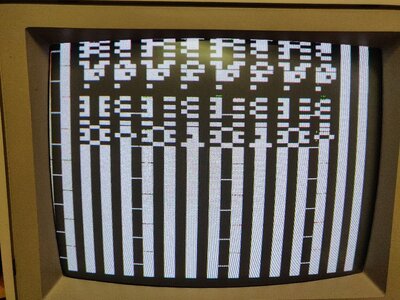

I got this QL unit a while ago - it booted Ok a few times except that one microdrive kept on running.
Then after power off and on it started to show just garbage on screen.... didn't boot anymore.
I now have the Minerva 1.98 ROM installed. I was hoping that it might give a hint on the RAM chips to check in case that might be the issue.
Unfortunately the screen is pretty messed up so, doesn't really help... Could it still be a RAM problem ?
Keyboard is disconnected currently.
Screen when micro drives were still connected

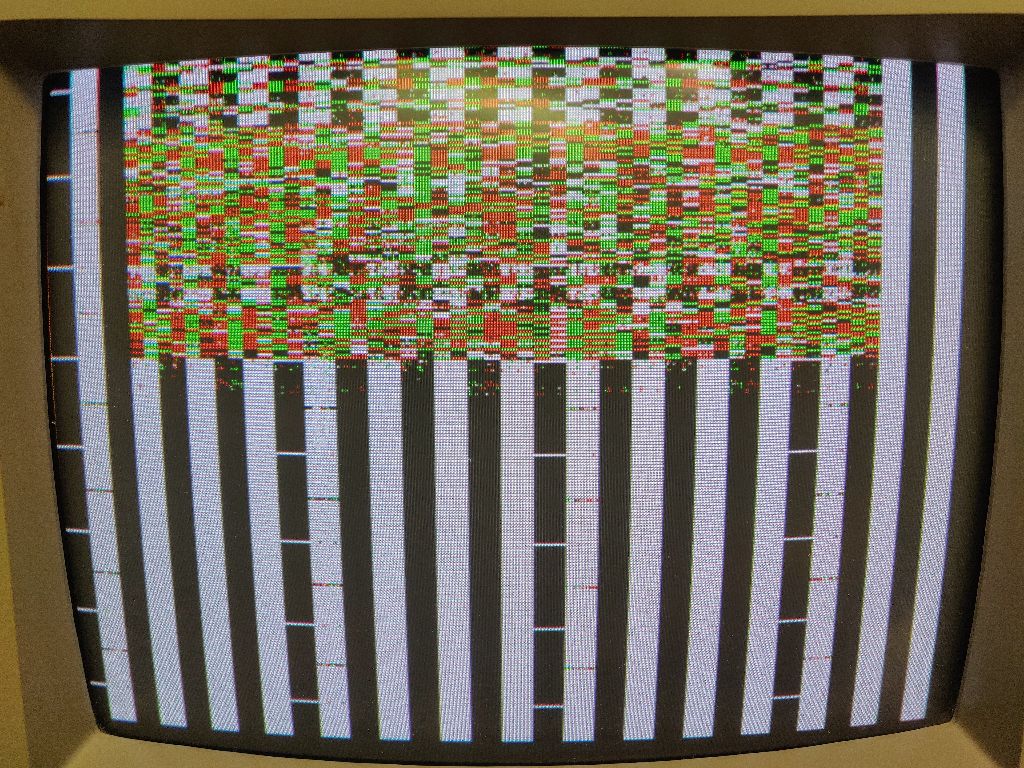

I removed both microdrives for now and the screen now seems totally different - but still not working.
Screen when micro drives removed

could be a RAM problem - or it could be a problem with the bus being loaded - the Zx8302 chip sits on the same part of the data bus as the RAM chips in the issue 5. Could also be the 74LS245 chip or either of the 2 mux chips that sit near it. Clearly the ZX8301 can see some memory or it would not generate the display, and what looks like the Minerva reporting a RAM issue shows that the CPU / ROM appear to be working.
So you have a few potential suspect players in there...
Posts: 3131
Re: Issue5 start problem
Yep, looks like Minerva would want to tell you something but cannot - The four lines with garbled text look like the Minerva RAM failure message, but garbled - because of a screen RAM (or multiplexer/bus driver) failure.
