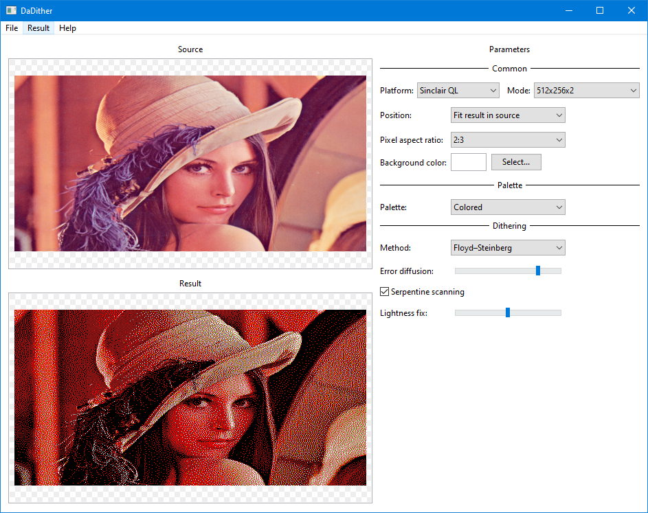

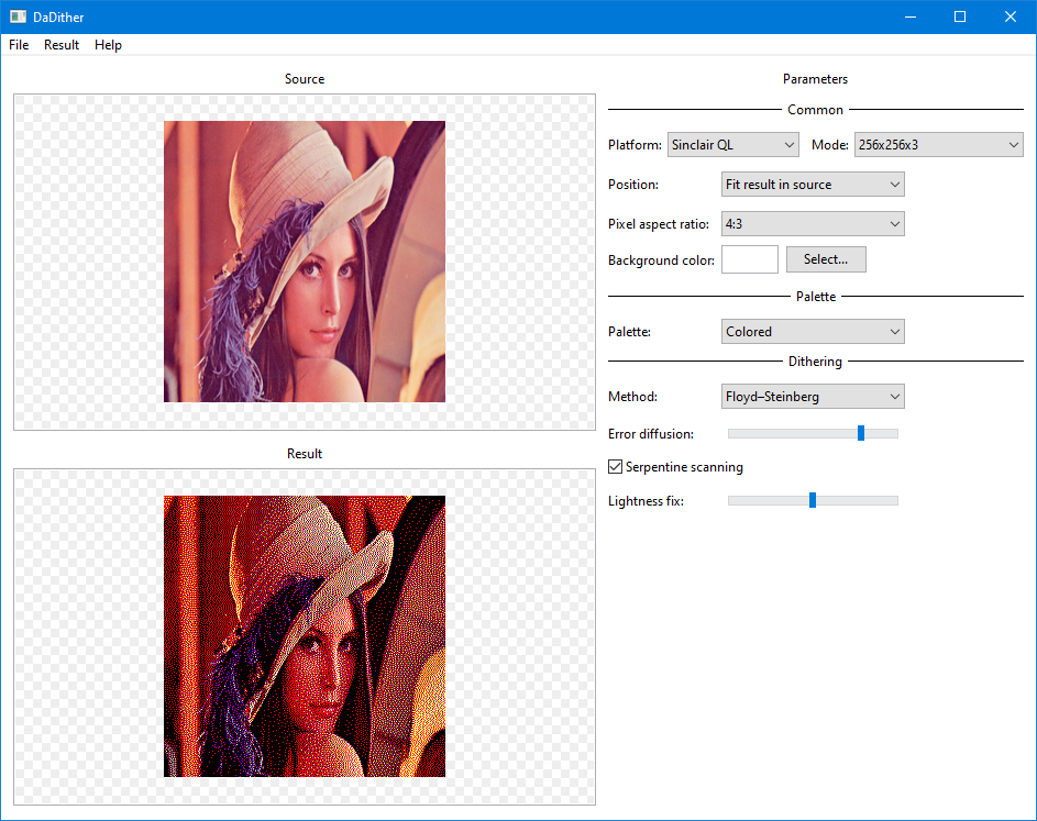

This is how my tool works:
Download link.
