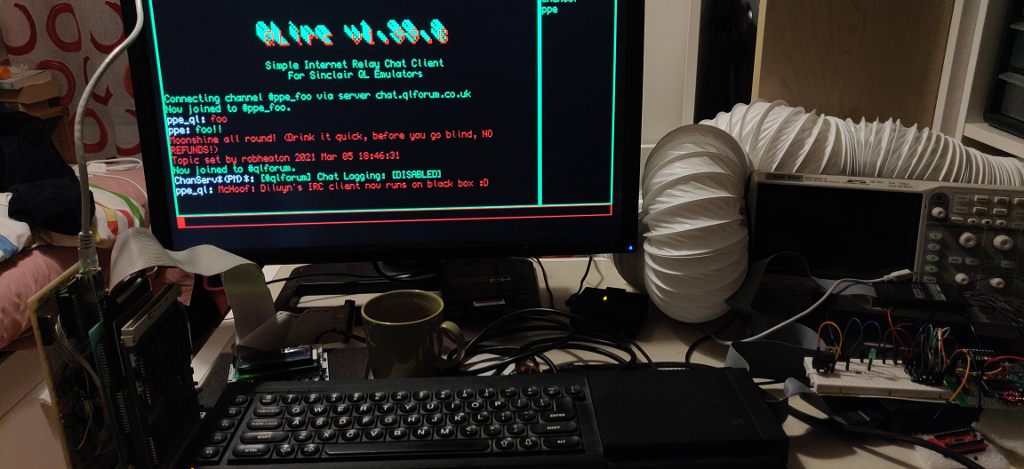

Dilwyn, it now runs on a 640 kB Black Box QL:
Oscilloscope not required. Sorry about the mess but am pretty excited to have a working tcp_ device for the black box
The driver currently supports PRINT, INKEY$ and INPUT on a TCP_ device which is enough for this IRC client. Uses the W5300 based network card.
