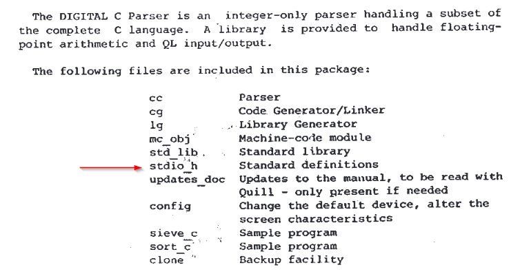

Artificer
Posts: 171
Re: Digital C SE Foibles on QPC2
Post by Artificer »
Hi
Norman wrote
#include <stdio_h>
even though no such file exits
Do you mean that you don't have the studio_h file which is part of the Digital C distribution. If not then that could be why things are not working. It is a 628 byte file that contains digital C's small C definitions including assigning channel numbers to stdin, stdout and stderr. It should be I think in the same location as mc_obj and std_lib. When I have used digital C I had always place all the digital C files in the same location, usually ram1_ and output the compiled executables to flp2_.
The simple programs you are testing do compile here on a Q68 using ram1_ for everything.
Cheers

Posts: 2497
Afternoon Artificer,
my apologies, I looked again when I saw your reply, the file is most certainly there. It appears I am no longer able to read a directory listing!
