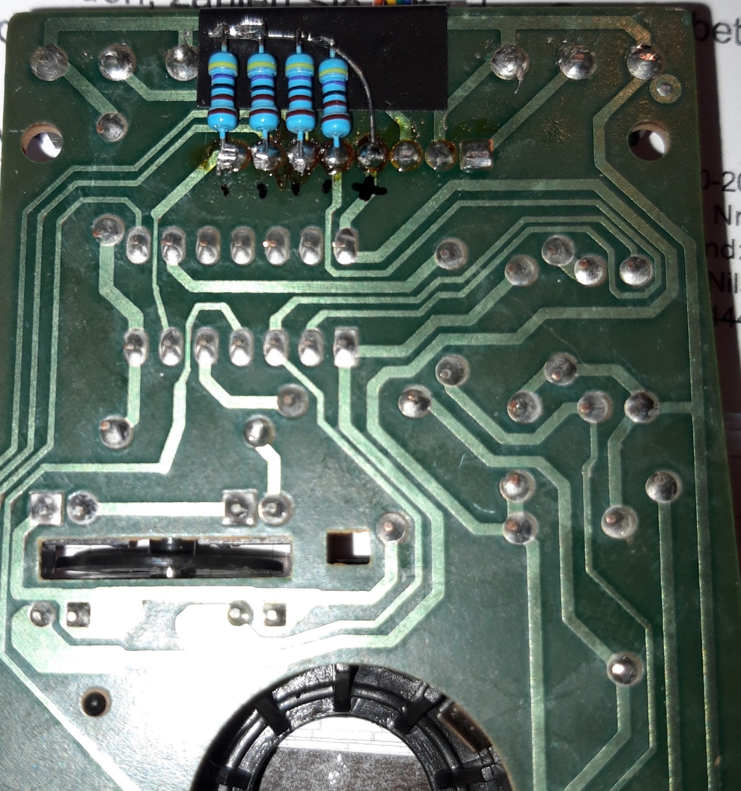

Very interesting, thanks. My mouse comes apart quite easily and there appears to be enough room inside to add pull-up resistors under the pcb between the +5v and the XA, XB, YA, YB. I can't damage anything in doing that, can I? I'm not all that qualified but I imagine the Qimi works in about the same way as your SuperQBoard setup?

This is what I've knocked up:
It all fits perfectly on the solder side with the mouse back together. I popped a bit of insulating tape on just in case, and rather conveniently the 4 movements wires were all in a row and right next to the +5v. I'll give it a try later today.
(if the resistor colours aren't clear, they are all 4.7k ohms)

No, still the same!
