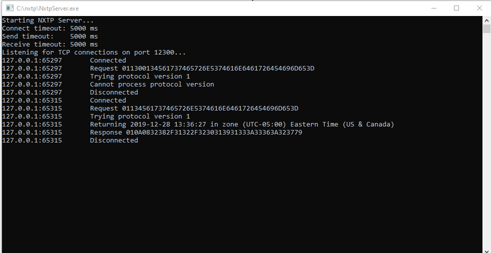

Today as a small break from the ZX Spectrum Next manual, I completed a nxtp client for TCP_ device equipped emulators; This is basically a simplified version of the ntp protocol as hosted by Robin Verhagen-Guest on time.nxtel.org . A client already exists for the ZX Spectrum Next so it was only logical to do the same for the QL. For QLs that have some form of a serial attached ESP chip, conversion is very easy using the SER device and I'll be glad to write that one too if I get some sort of feel of what's the preferred ESP based solution for QLs; I've been away from QLs for a very long time so I'm not totally up-to-date on things :) Attached, there's a screenshot of my QPC2 connecting to my local nxtp server and its response: I'll be posting the executable once I'm done debugging it (in a day's time or so).
Of course someone would ask: Why? The answer is simple: why not? I'm basically prototyping here; I can get Q68 to talk to an ESP via SER but ideally I'd love to see Peter's QLuwIP solution; I used that with my Q40 years ago and it worked great.
