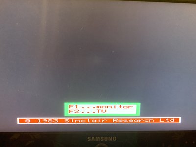

Got my QL today.
This is what I see:
Pressing F1, F2 or any key has no effect and pressing Reset has no effect.
Can you please help me trouble shoot?

Got my QL today.
This is what I see:

Hi
Sounds like the keyboard membrane needs replacing.

Hi Bill,
the reset switch might have corroded contacts perhaps. I wonder if a quick squirt with switch cleaner might help. Not WD40 though, unless any of the real electronics gurus on here say otherwise.

I would not put WD40 or any aerosol oil into any electronics.
At the bear minimum use a alcohol based IPA srpay.But you need to dismantle the Reset Switch to see what is wrong.
The contacts that perform the electrical contact to give a reset signal maybe missing.
When you get the new keyboard membrane and have fitted it, look at the reset switch.
