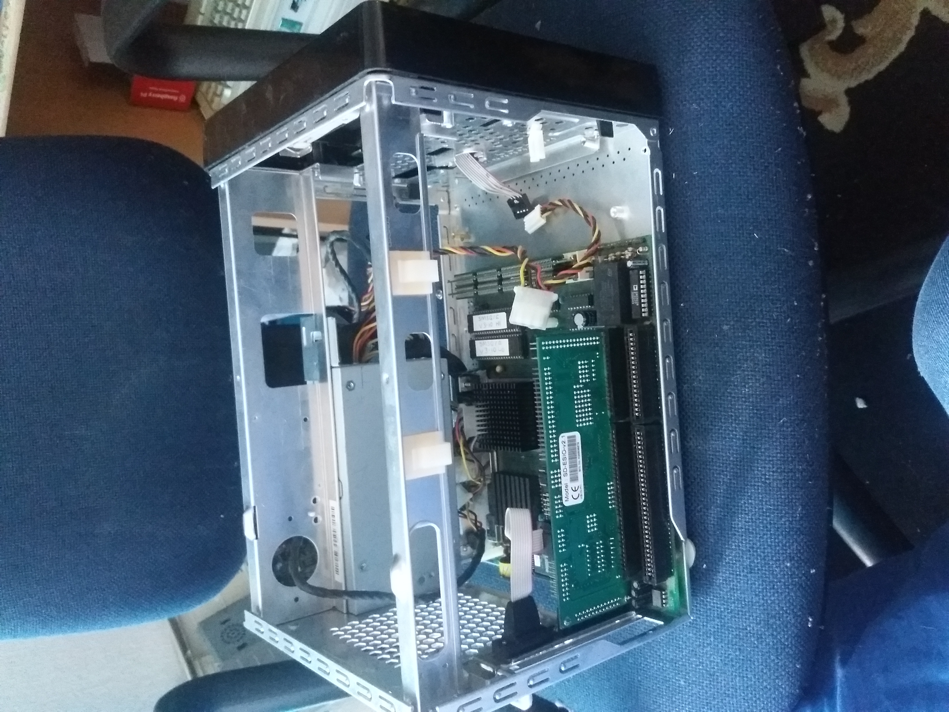

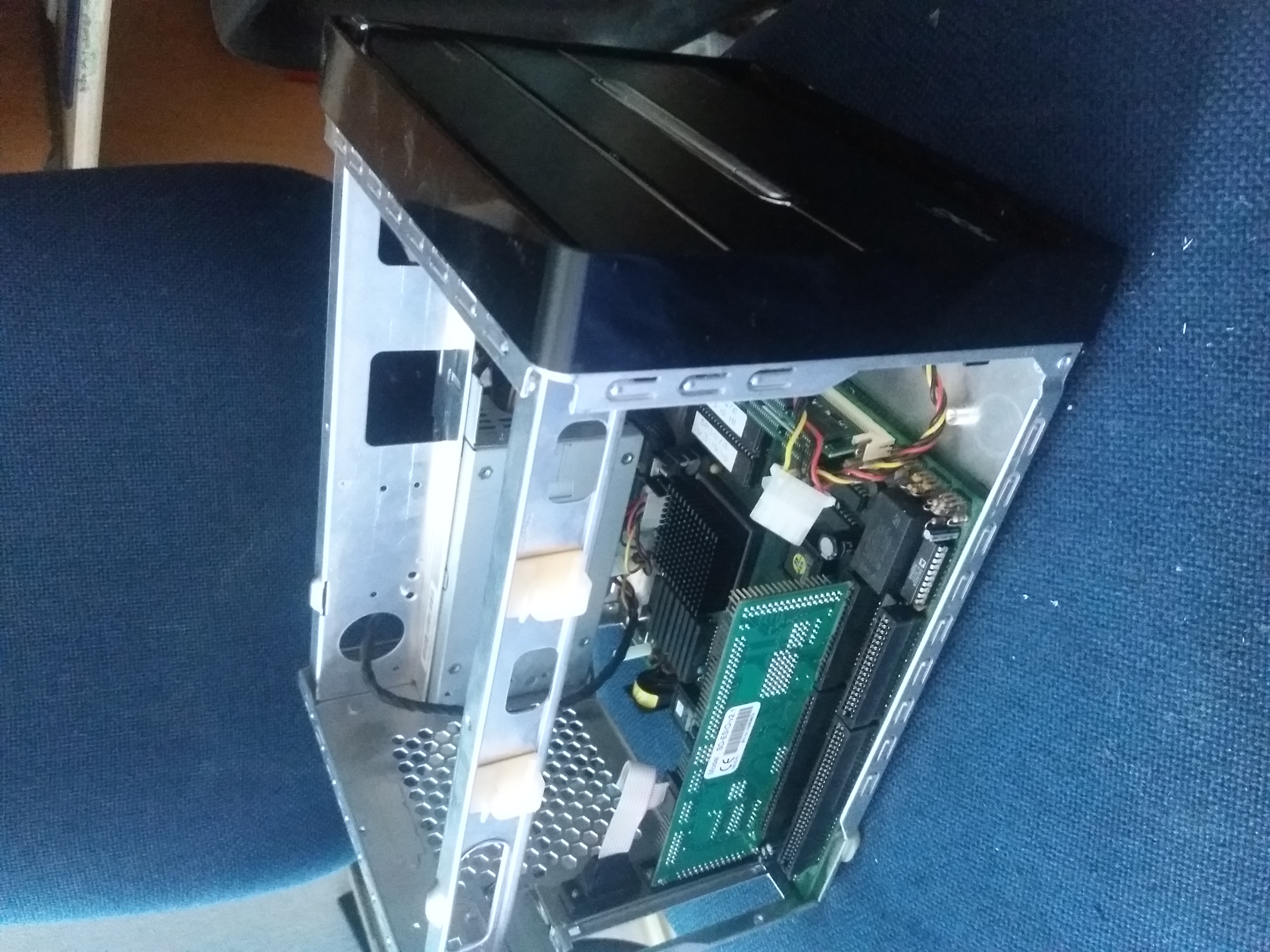

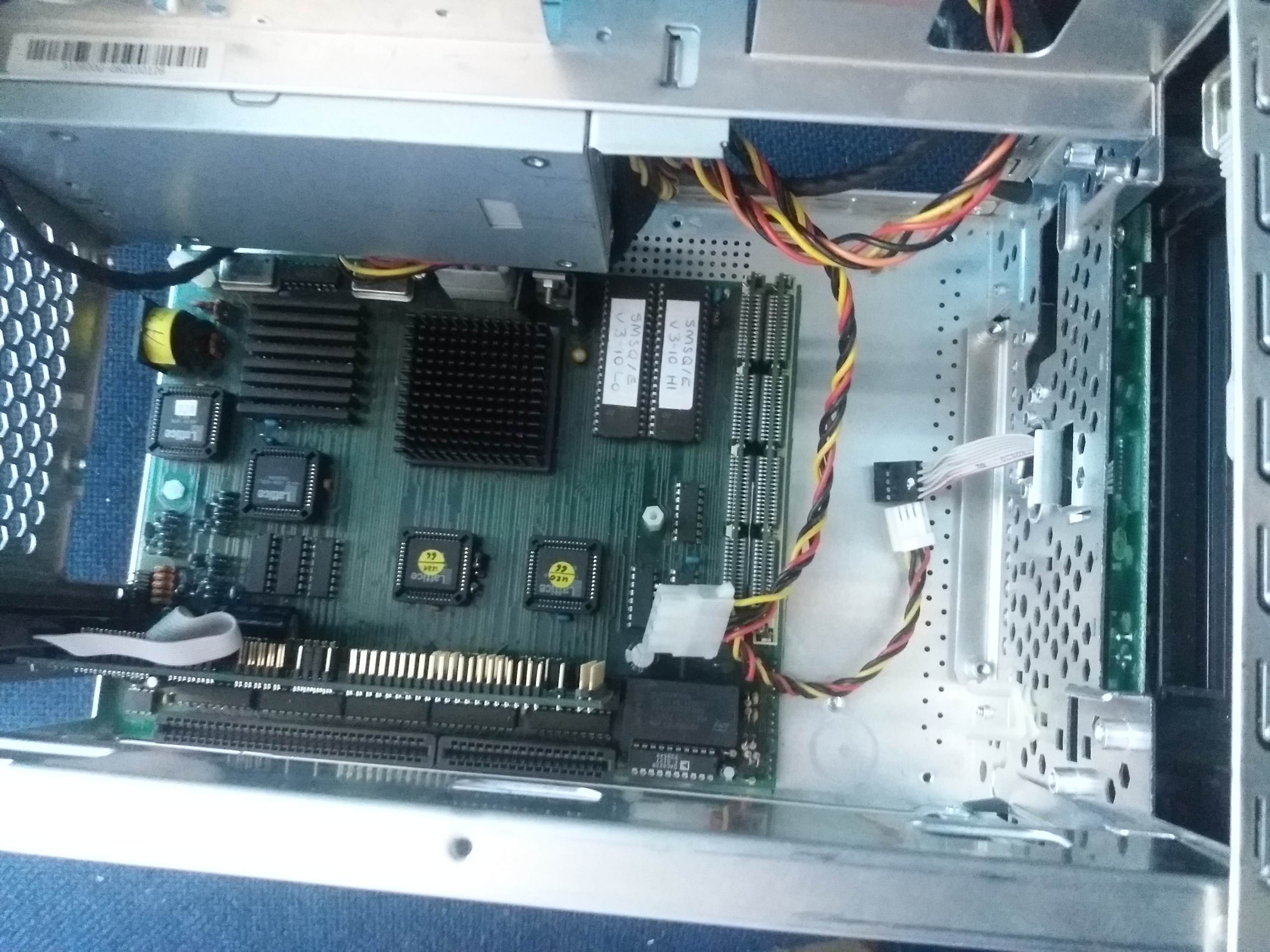

I used to have Q60 in a Silver Shuttle case, but here is a Q60 in a Black Shuttle case.
The forum software is rotating the pictures.

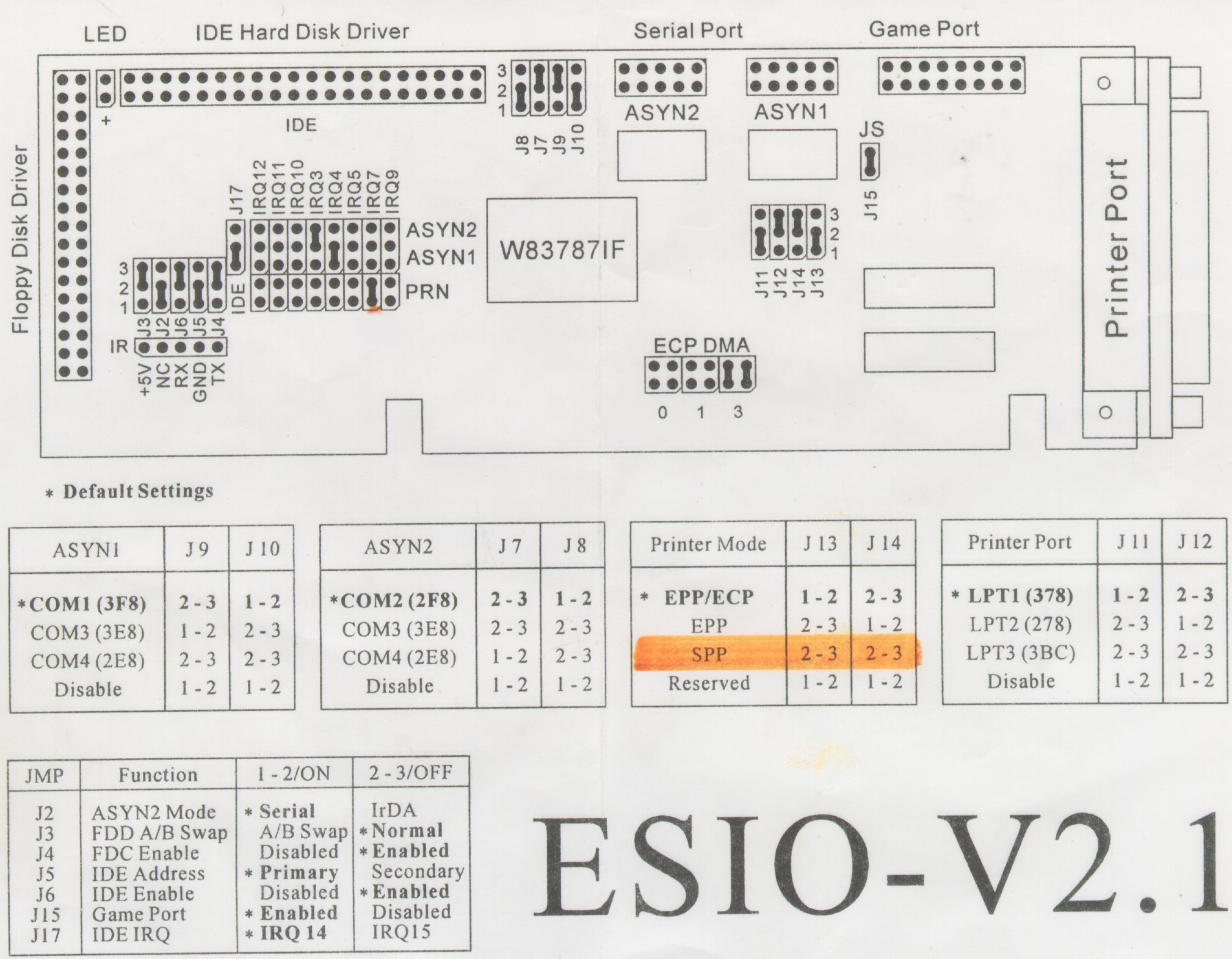

Derek,
What is the SuperIO on that Q60?
Posts: 4796
Re: Does ITX Cases work for any QL Compatible Motherboard
Dave wrote:Derek,
Hi Dave,
The Q60 in the picture is fitted with a SD-ESIO V2.1 ISA I/O card. 2 x IDE, 2 x Serial, Parallel, Game port.
This was a standard I/O card fitted to the Q60 sold back in 2003.
Here is scanned copy of the info sheet for the card:
Q60 I/O Card
Q60 I/O Card
The highlighted SPP, was the Parallel port mode that would only work with SMSQ/E in 2003, this was coded for the ill-fated Qbranch Q40.
Which, I and friend successfully sold the Q60 and a Q40i
The I/O Card was later replaced with a 4 x IDE card.

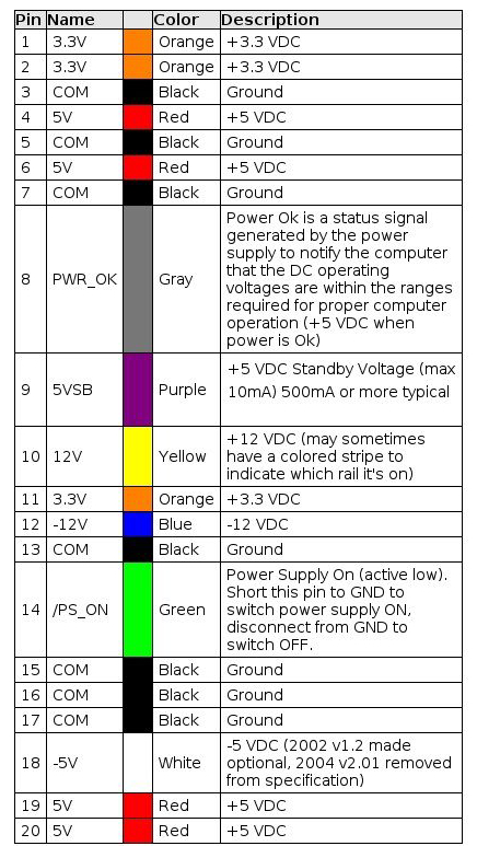

I am completely restructuring my Q60 and Q40 with new case, HD etc. I am pretty sure I can use an ATX power supply instead of the original AT being the voltage equivalent (5 & 12 Volt). Am I right?

Posts: 4796

bixio60 wrote:
Hi Derek,
I know that I have to short-circuit pin 4&5 on the motherboard main cable to get power on the IDE Molex connector, but at the end I need only Ide Molex.
See the diagram below, showing the ATX Power Supply connections:
ATX Power Supply 20 pin connector
Most ATX power supplies have suitable disk drive and hard drive power connectors, which will also power the Q40/60.
To switch on an ATX power supply, pin 14: /PS_ON should be connected to GND and switch off disconnect from GND.
I used short pin 14 and 15 to power the ATX power on.
ATX Power On
ATX Power On
Q40-60 atxpowera.gif (4.55 KiB) Viewed 6340 times
But a push to make switch could be fitted to power the supply on. Or a simple flip-flop circuit could used to connect the ATX switch.

I have fitted these to an ITX Case: Q40, Q60, Aurora SGC QL Mplane (for a customer)
SQL board would need the Microdrive section cut off, which has been done. Power connections can be made at the expansion port.
The Q68 could be fitted into an ITX Case, but the size of case is too big.
No bodge required, the Q68 only needs 5v from the ATX power supply with a simple 2 wire adapter.
